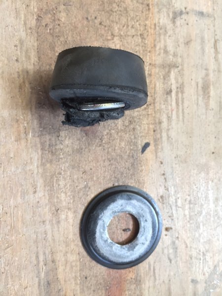

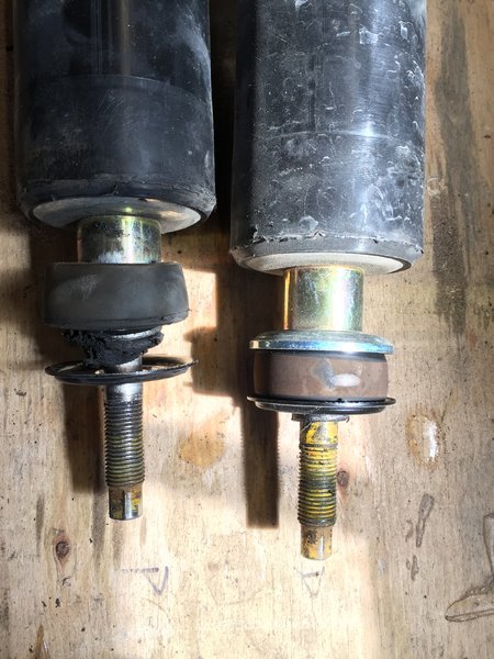

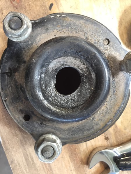

    Whelp I pulled the front shocks from the coil overs and found the passenger side to be banged up pretty bad which explains why the top nut was threaded all the way without tightening. Looks as if the lower bushing is missing its lower washer which since I had the company I ordered from assemble them I have no idea if it broke off or was never there. Trying to contact them now. The shocks themselves have very little recoil response and since the the top of the passenger side is now worn I have to replace them anyway but I got to say only having them on for 2 years and 30K-40K I am disappointed in how they have held up.

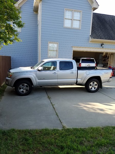

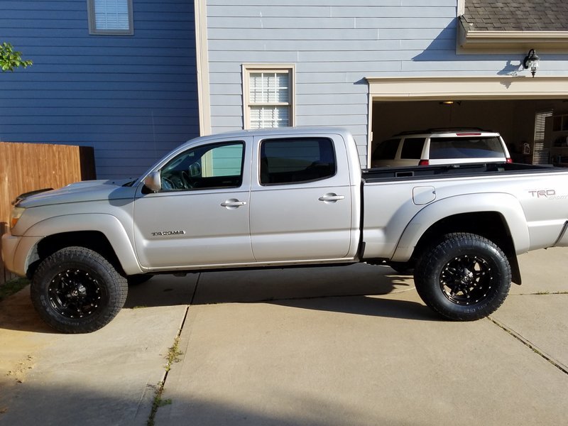

    Finally got my OME lift installed! 885s with dakars and LR UCAs. 285/70/17 Nitto Grappler G2. 17×9 Fuel Hostage wheels 5 BS and 1 offset. Minimal trimming. Need to trim just a bit more on front passenger side, as I'm rubbing slightly in reverse. No CMC. The ride is great! Here's the before and after pics. They don't really do it justice though. Loving this setup!20170421_083504.jpg 20170422_180333.jpg

    Looks great, did you cycle the front suspension to ensure you don't need a CMC?

    Sorry, I'm a noob... Not sure what cycle the front suspension means. Had it installed at a local shop that specializes in lifts and such.

    As for the rubbing in reverse, I've read other posts where guys have commented about it rubbing in reverse. Why does it rub in reverse but not going forward? Mine only rubs slightly in reverse and turning.

    It means putting the suspension at full stuff and droop and turning the wheels full lock to full lock to see where any rubbing will occur.
