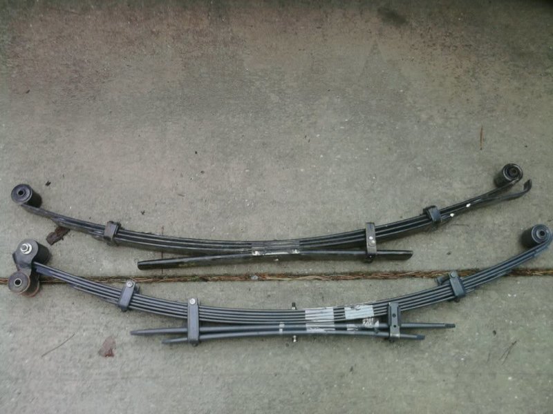

    So which leaf is this exactly? Do you know of any threads where I can see this?

    The 2 flat ones at the bottom of the pack. IMG_0247.jpgThe longer on can be removed.

    So whats the difference though between taking out the third leaf from the top vs. the overload leafs? Doesn't OME only recommend taking out the third leaf?

    Removing the third leaf from top makes that pack softer as well as lower the ride height. Removing long overload only lowers ride height. That info is straight from ARB. So yes they are ok with it.

    Sweet... so I should expect to be about a 1/2 an inch lower taking out the overload

    Yes

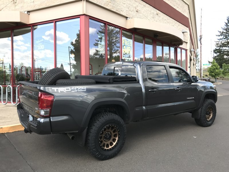

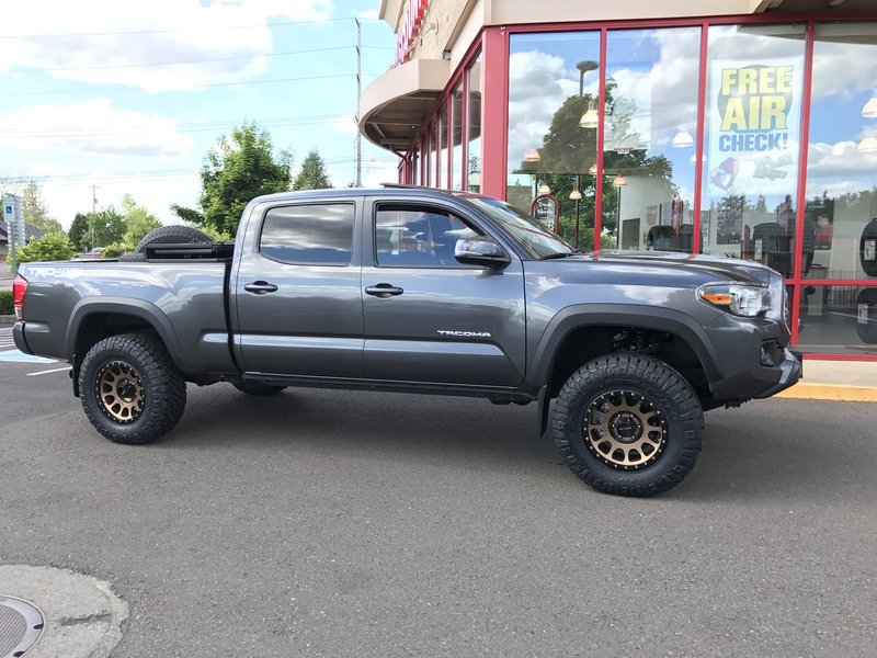

    Here is the build for my '17 TRD OR DCLB:
    3" Lift:
    OME Kit with Nitro Charger Shocks
    OME 888 Front Coil Springs for 2016+
    Softer Ride Nitro Charger Sport Front Shocks
    OME Trim Packer for 05+ Toyota Tacoma
    OME Nitrocharger Sport Rear Shocks
    Deaver 1.5"-2" Lift Add-a-Leaf
    Center Bolt - 3/8 x 4.0" FT w/ Nuts
    MaxTrac 4WD Diff Drop Kit (not installed yet)
    Wheels/tires:
    17x8 Method Bronze NV (yes, bronze and. It black!)
    Nitto Ridge Grapplers 285/70/17
    Ordered the Shift Sense pro and waiting to arrive. Also ordered some recovery gear such as hitch receiver, bubba rope and gator soft shackle.
    Ugh, this is fun but the mod bug is definitely infectious and wallet-draining. My direction is overlanding but will enjoy the bro-look for now.
