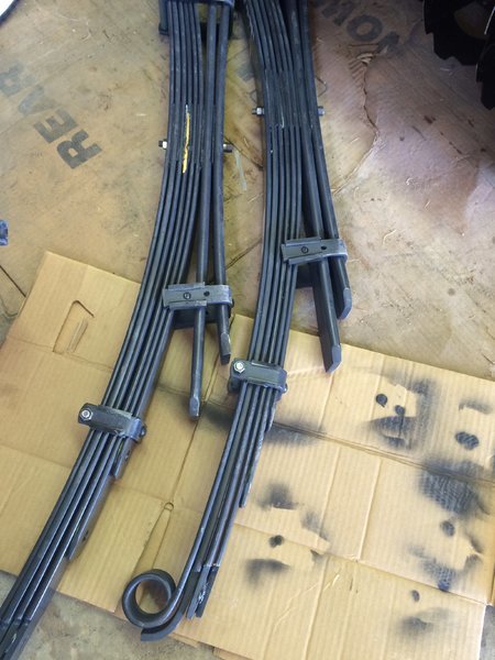

    Full Dakar leaf pack plus the d29xl aal. I was lucky to get the updated version with isolators already installed. I had the aal drilled so I could put isolators in that as well. The new pack also had thin metal isolators in the center so I had to find something that would work for my aal. I ended up using a plastic ice cream pail (2 layers each leaf) to make a spacer.
    I also installed a new, longer center pin, with a collar (for a 3* axle shim) which was the perfect length for adding the aal and collar.
    Just a crappy quick iPhone picture.
