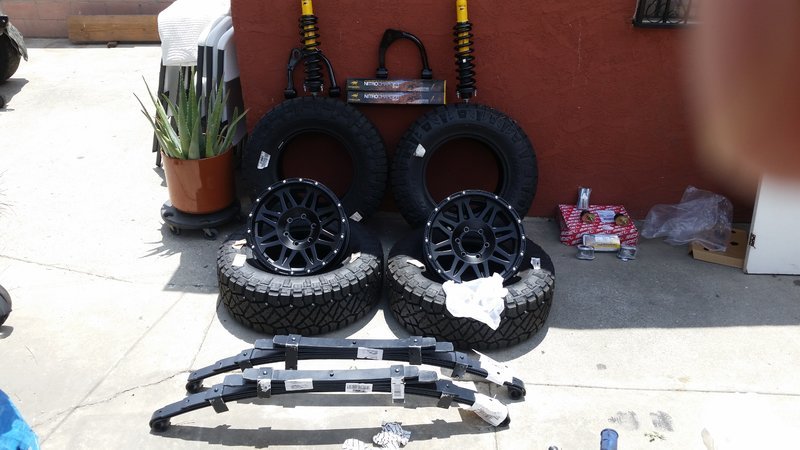

    20170610_115935.jpgOME complete kit with light duty Dakars.
    Pro Comp 7005 series.
    285/70/17 Nitto Ridge.
    Need to save up for the installation should have everything installed in 2 weeks.
