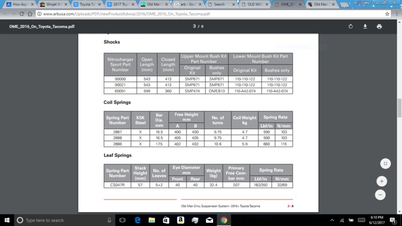

    I also stated highest spring height not spring rate...

    Thanks. Not sure why that company would call 885s stock and 888s medium if they're the same spring rate. What company said this?

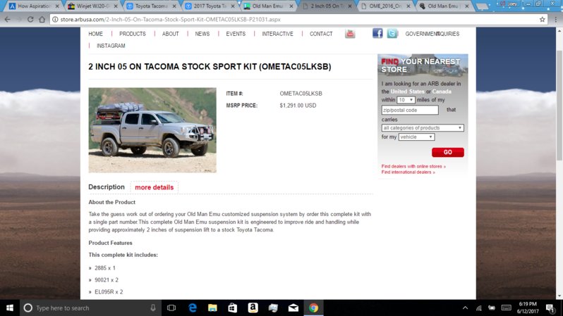

    So the ones i posted in the last picture were for third gen going from stock, medium, heavy. This is directly off arb website for 2nd gen tacomas. Stock kit utilizes a 885 coil.
