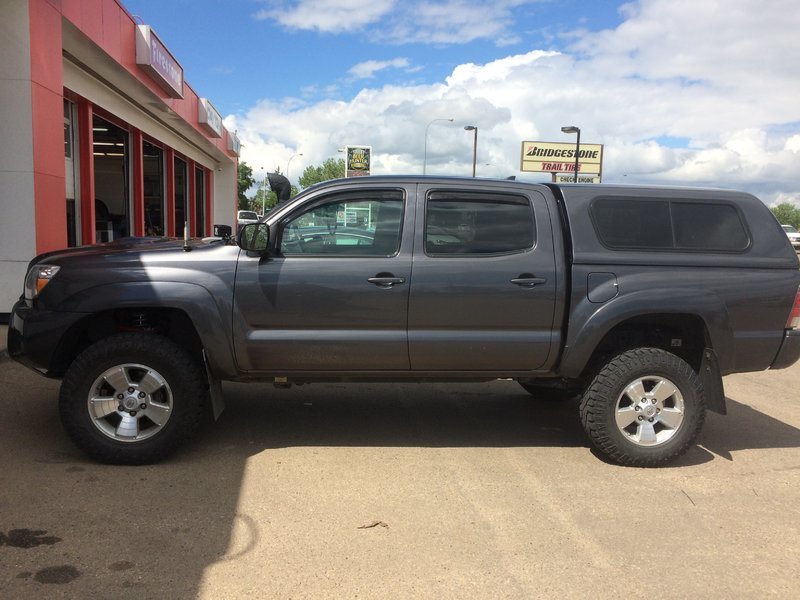

    Update time.....dropped down to the 2nd notch and things are looking much better. I am just about to leave for an alignment so I'll try to get some pictures when I get back.
    At the tire shop...it'll have to do for now. Happy with the stance now.

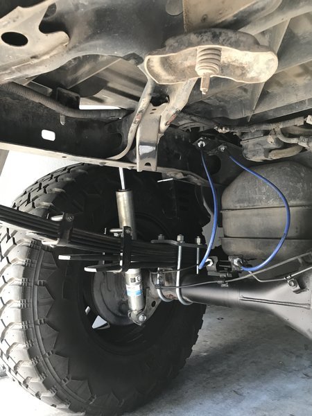

    What shock you running with that? About to pull the trigger on this dakar pack

    Bilstein 5100 b110

    Thanks. Gonna order these and install with standard length 5100s to see how close I get. Plan to order extended length in a few months. No hardcore offroading planned

    You won't get close at all with standard length shocks..they will be WAY short....I almost use all down travel of the extended shock

    Buy shock extenders for like $20. Gets you most of the droop which you don't really care about since you don't froad.
