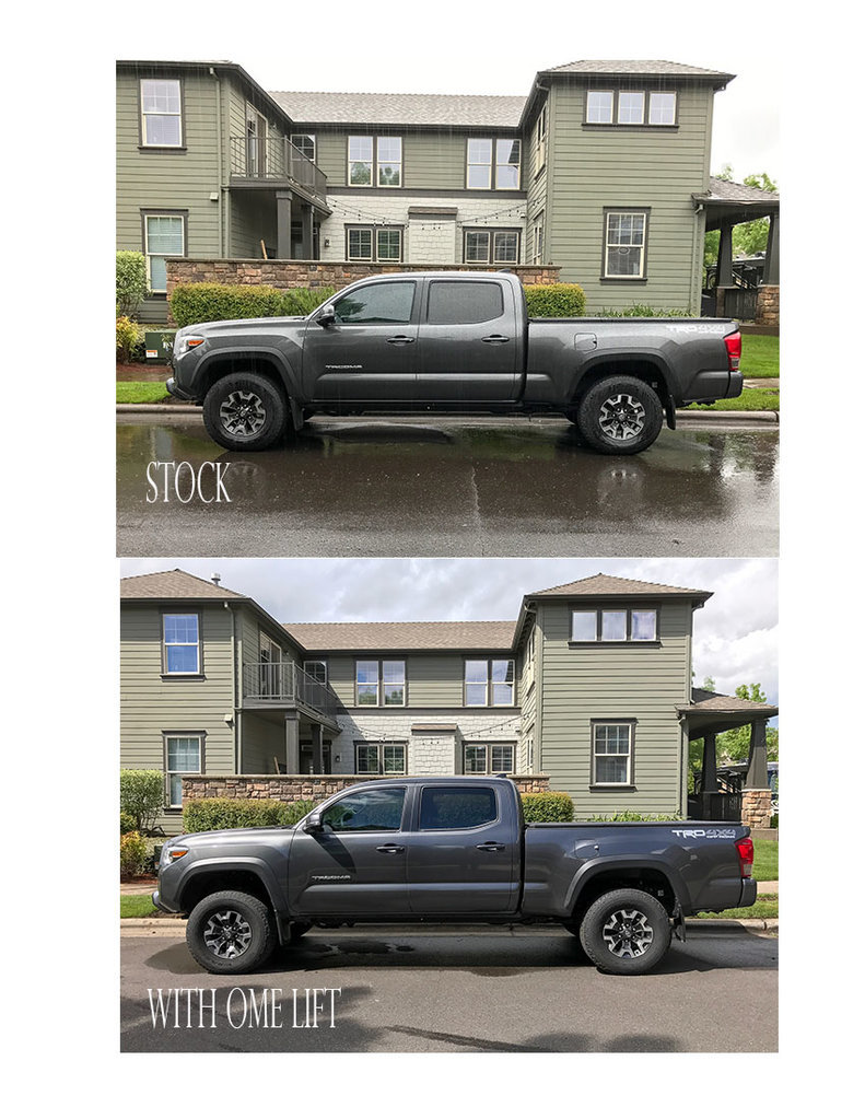

    Hey 3rd gen DCLB here. I have an OME kit with 888 coils and nitrochargers upfront and an AAL in the back. I also have the drivers side trim packer and installed the diff drop as well. Even with 888 coils, my lift brought me even to 23" center hub to fender all around. Attached is a pic of my before and after.
    If I could do this OME kit again, this is what I would do:
    OME nitrocharger (firm, not soft ride)
    1/4" top plate spacers for additional lift (to offset sag)
    Drivers side trim packer
    888 coils
    Dakar light duty packs
    LR UCA's, diff drop, carrier bearing drop and ECGS bushing all for insurance (just do it all at once to avoid doing it again and again)
    I took a budget approach and skimped on the little things and am now ending up buying it a la carte. the AAL was fine in the beginning but I've since added a mid cab rack and RTT along with camping gear. Now the back is sagging and it doesn't look and feel good anymore. Good luck with your journey and remember, "but once, cry once!"
    Loaded and 3k mikes later

    Thanks for that informative response. That was super helpful and I really appreciate.
    One question- why would you go with the firmer tuned shocks?
    How do the softer ones ride in comparison to stock?

    Why firmer shocks? Preference, I guess. I loved the stock "floaty" feel of the stock OR suspension, so I initially wanted to maintain that feel. There's absolutely nothing wrong or bad with the soft-ride. It's just "playful" and now that I'm hauling more stuff, I think firmer would be better on-road and with MPG....but that's just my thoughts. I would love to hear if anyone with the firm ride would prefer the soft-ride version....
