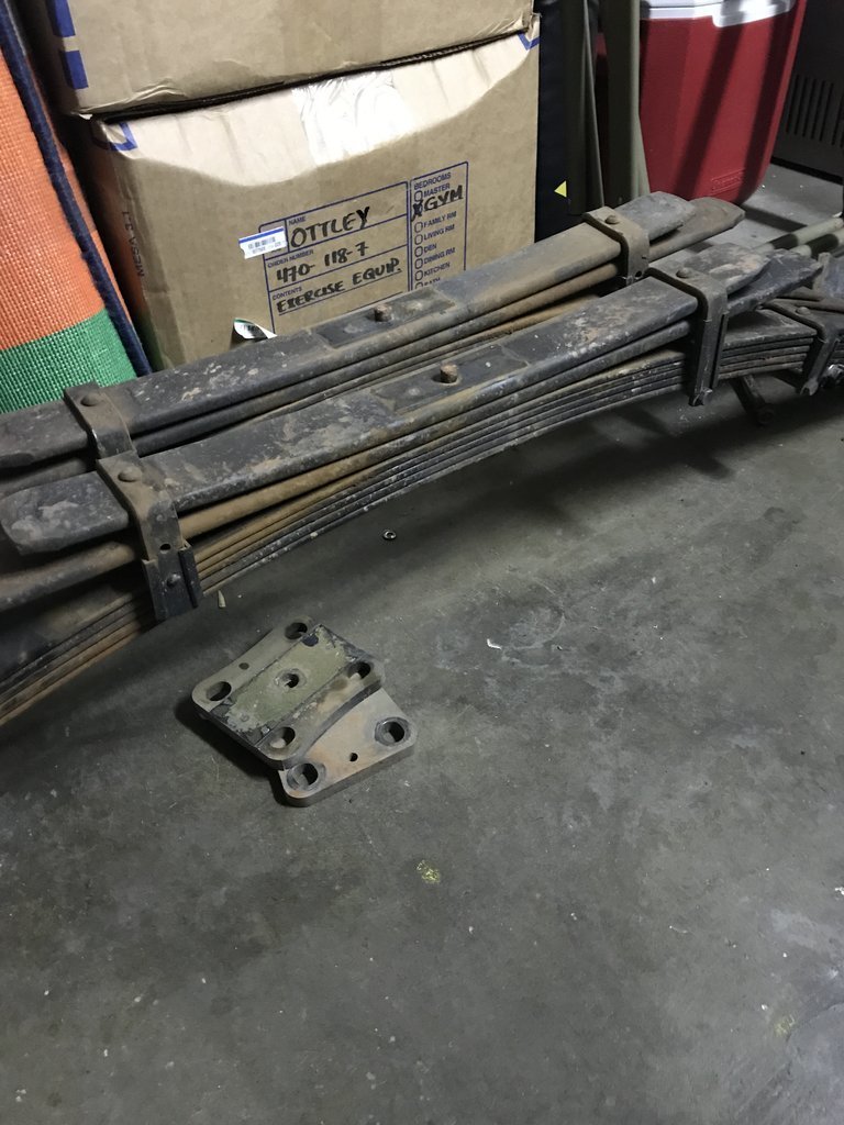

    As mentioned it is long enough but if you ever need to add a center pin collar for an axle shim it will not be long enough. Below are my Dakar packs with the d29xl aal, center pin collar and longer pins. I bought an axle shim kit from Headstrong which came with longer pins, collar and 3* shim. Sorry for the crappy iPhone picture.

    Great info man thanks! what exactly is the axle shim kit for and how much weight to you carry around on a daily basis? ive been told mixed reviews that the AAL will be too much for my daily 300ish lbs and others say it will be just right...

    The axle shims go between the bottom of the leaf pack and the axle. They help fix driveline angles.

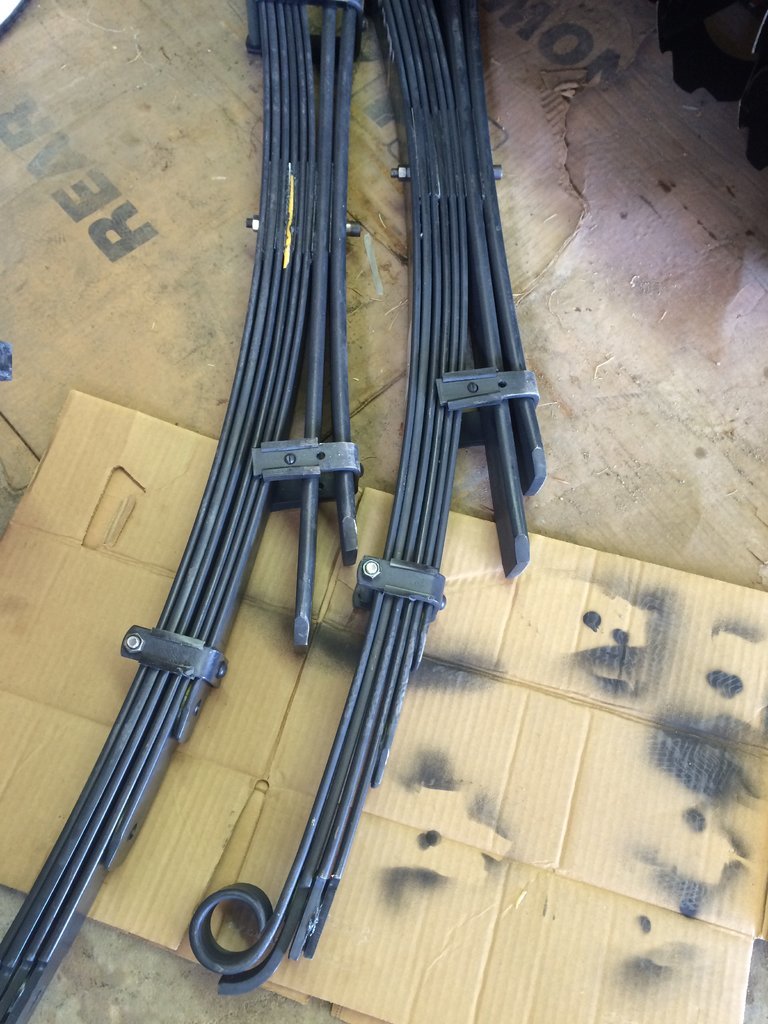

    attached are the used dakars I'll be picking up when I get back... can anyone tell if these have the AAL already or is it the standard pack?

    No, the standard pack is a 5+2. 2 overload and 5 leaf.

    thanks I think what im going to do to save some money is throw these on as is and see how it handles my weight in the rear... then I can always add the extra leaf if needed... but im right around 300 steady load with the steel rear bumper dual swing arm, full size spare, jerry cans and camper shell

    Not a bad idea. I would wager you will end up putting it in though.
