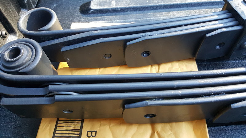

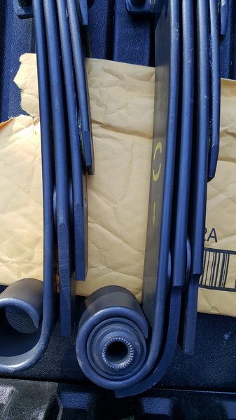

    Whats the difference between the new and old packs? I don't want to put old packs in if they have issues...

    yeah even though I was basically going to get the older style for free... now I don't know if I want to get the newer style to be safe from the squeak monster lol

    Your call.....I was lucky and got, what I'll call version 1.5, that are the old style leafs, with isolators for all the leafs and no front rubber OEM style bushing. From what I've seen of the new (2.0) style leafs, they don't look as good (like a DIY'er) built them and the paint/coating looks cheaper. I'm glad I got the set I have but I would have been happy still if I got the 1.0 squeakers over the 2.0 packs.
    FYI- I found a local spring shop that drilled the d29xl aal springs and put in isolators. Extra cost but I was putting them in the pack and didn't want them to be the sqweak link. LOL get it? ;)
    Danactive[QUOTED] likes this.
