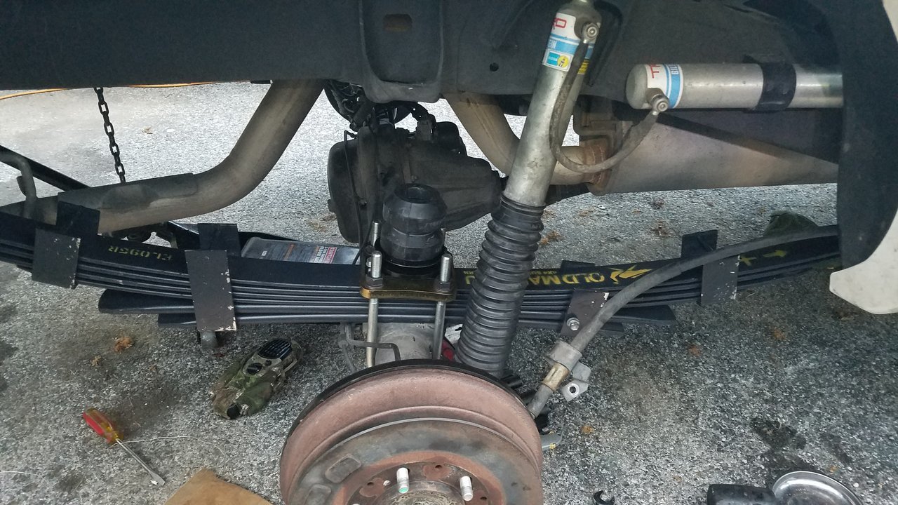

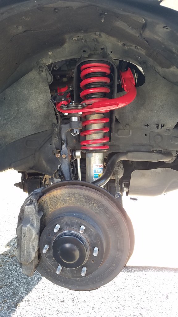

    20170806_074540.jpg 20170804_200909.jpg Curious on how much height u loose onces the leaf settles.
    Just finished installing the OME LD Dakars with B5160s over the weekend.....have an ARE CX-series cap, some misc gear, hi-lift jack and a shovel. I'm ~ 2.5" over stock....just hope i dont loose it cuz im pretty level right now. Fronts are B6112 set at the 2/1 notch and JBA HD UCA.

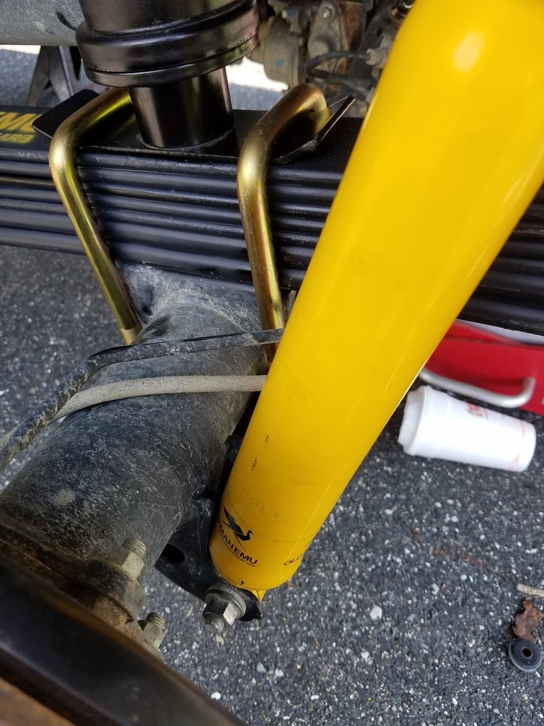

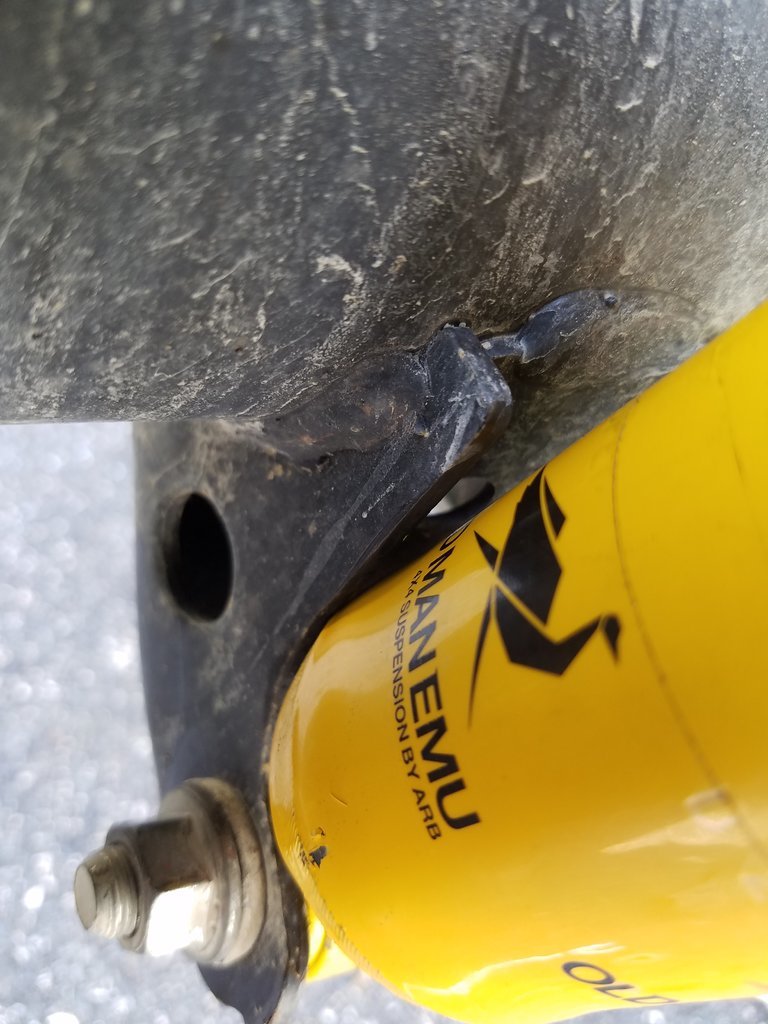

    Does this look right? OME 60091 touching the bracket where it mounts, OEM shocks are so skinny they don't touch at all20170819_141105.jpg
