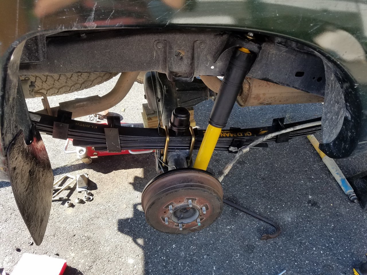

    YanE30M3
    YanE30M3 GO PATS!
    Sep 26, 2014
    #139118
    1,680
    Yan
    Woodbridge VA
    15 TRD Sport (DCLB-BRM) - 88 ///M3 (Zinnoberrot)
    OME 887/Dakars/NV305s/33" Duratracs/+
    I had to cut some of the bracket to fit my OME shocks

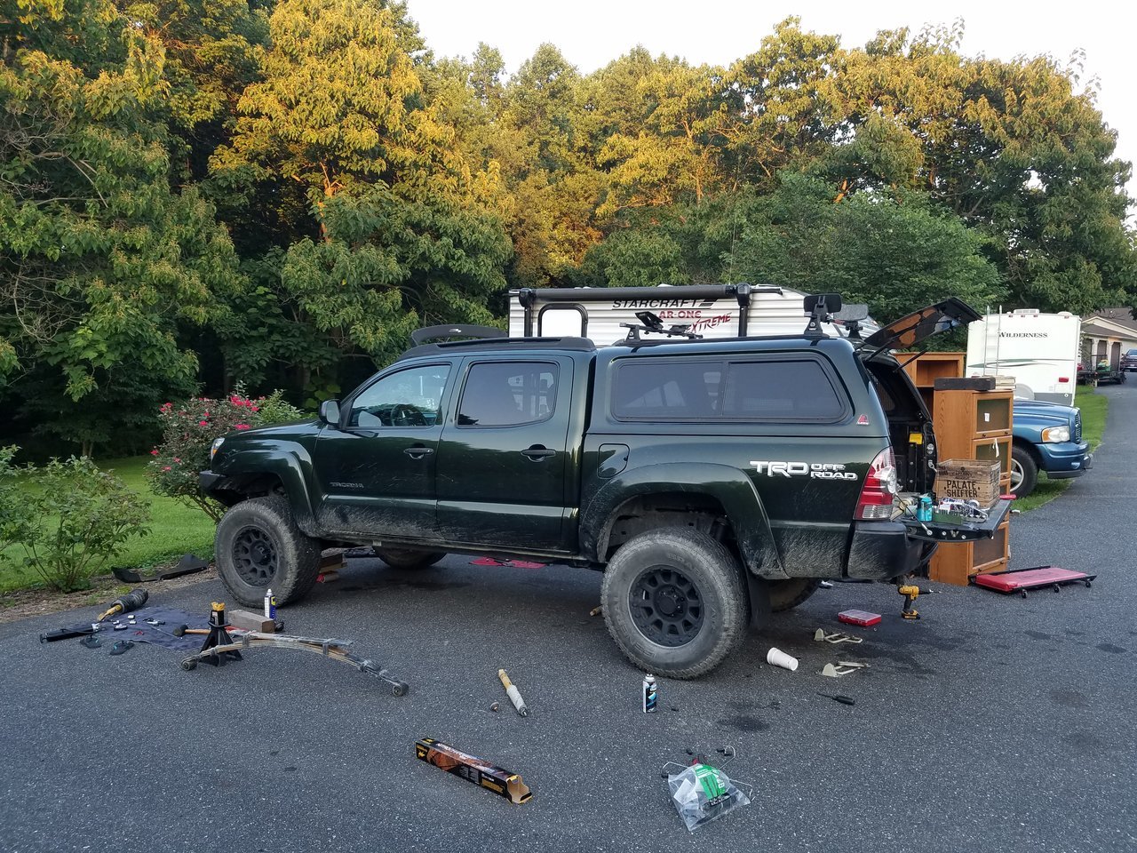

    20170819_192923.jpg Finished everything. Here's a messy pic before cleaning up, gained 1.25" in the front with the 886 coils/9000 shocks over my Toytec 2.5" spacer. In the rears I gained 2.5" on the driver side and 2" on the passenger, had the OEM pack with 1.5" AAL previously. Not excited that it's uneven but hoping it'll settle. I installed the ome shocks and Dakar HD pack rear, pack with the plus sign on the driver side and the 0 sign on the passenger.

    Looks awesome! I love the "after party" of tools and parts after working on the truck all day. I just replaced my CV boots and it was a bit like a bomb went off!

    Haha it's amazing how many tools you end up with at the end of a job

    Looks great, post some more pics after your done with that yard sale.

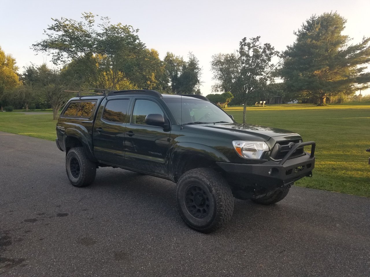

    Had an alignment done earlier. Gonna take it back for another tomorrow since the camber settings are pulling the truck a bit20170820_190605.jpg

    Decided against doing a flip kit while you had the back end apart?

    Yep, I asked the guys at headstrong and they didn't think it was necessary. Where the u-bolts secure to the axle it's so close to the wheel it wouldn't be an issue unless you take it over some serious rocks

    Yeah people debate whether or not to do it quite frequently. I did mine and 5 years later the bolts are dented and scratched to shit but my truck sees rocks too. I figure its one less thing to worry about hanging low.
    You're truck looks great.
