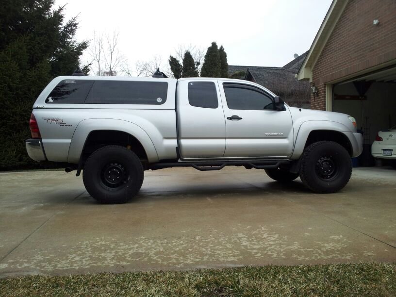

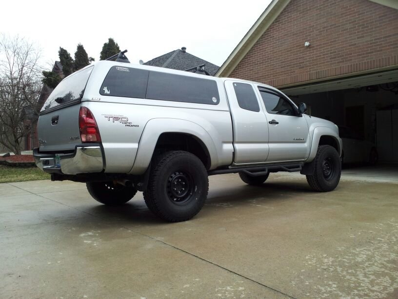

    OTT tune 3 degree cam gear OME/Dobinson
    885s, no top spacers, Dakar's 285/75/16s on 1st gen Tundra steels (16x7 +15):

    What size tires? they looked stuffed as heck up in front. No cab mount chop?

    285/75 on 1st gen Taco/Tundra steelies ... I expected more lift in the front but happy the way it ended up.. handles the rough roads much better.. . No cab chop, but I do have 1st gen mud-flaps and the front flares are slightly trimmed.... no rub at all
