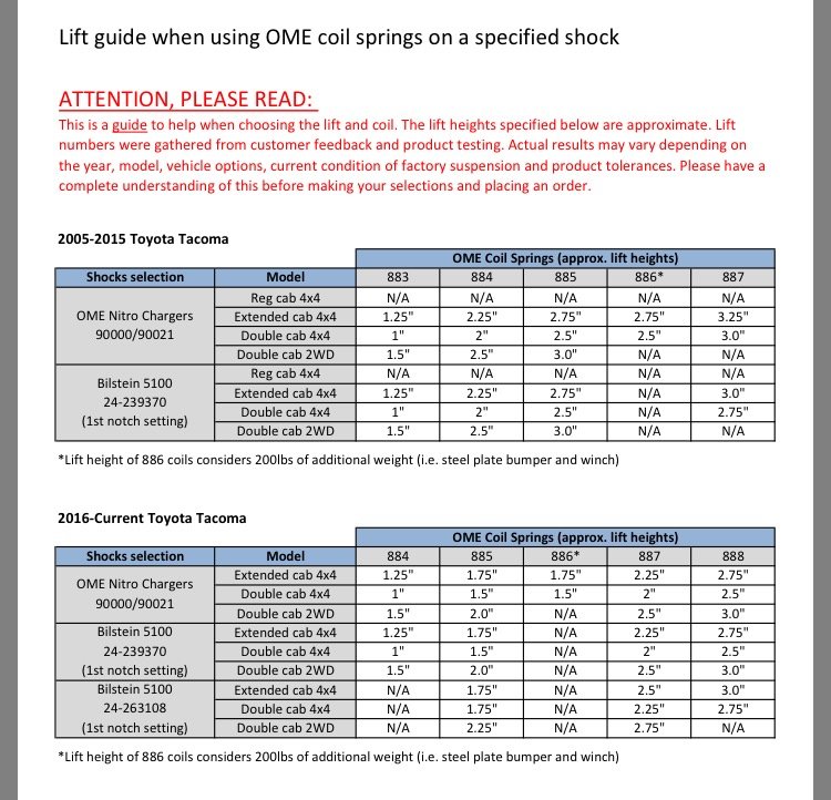

    I ordered the OME 2" lift kit (OMETAC16LKSB) for a 3rd gen DCSB OR from lowrangeoffroad. It comes with 887's and 90021 Nitrochargers for the front. Lowrange specifically said I wouldn't need aftermarket UCA's for proper alignment because it's "only a 2" lift". Can anyone confirm or deny this?

    You probably won't but you won't know for sure until you align it.

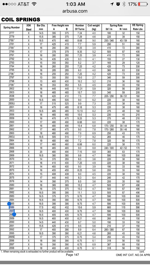

    Do you have to worry about the OME shock length with the 887's...? Looking at getting this down the road. I imagine that OME would have given plenty of length for any spring.

    They're 402mm like the 886s right? If so plenty of people roll that setup.

    The 887s are slightly longer than the 886s. I ran OME on my Jeep but only 2 inches with nitrochargers. Just don't want to max out the shock with the longer spring getting 3 inches.

    No.. 886 are 2mm longer.

    Don't tell ARB that... From their catalog, they list the 886s as 402mm and 887s as 400mm

    Yep. Was thinking lift heights I guess.
    Actual length on Headstrong Off-road shows the 2mm difference. I imagine due to the spring rate/coils you get more lift on the 887... Guessing.

    886s have a 660lb spring rate and 887s have a 590lb spring rate... 886s should be taller, the lift heights in the table above are because they factor in 200lbs hanging on top of the 886s.
