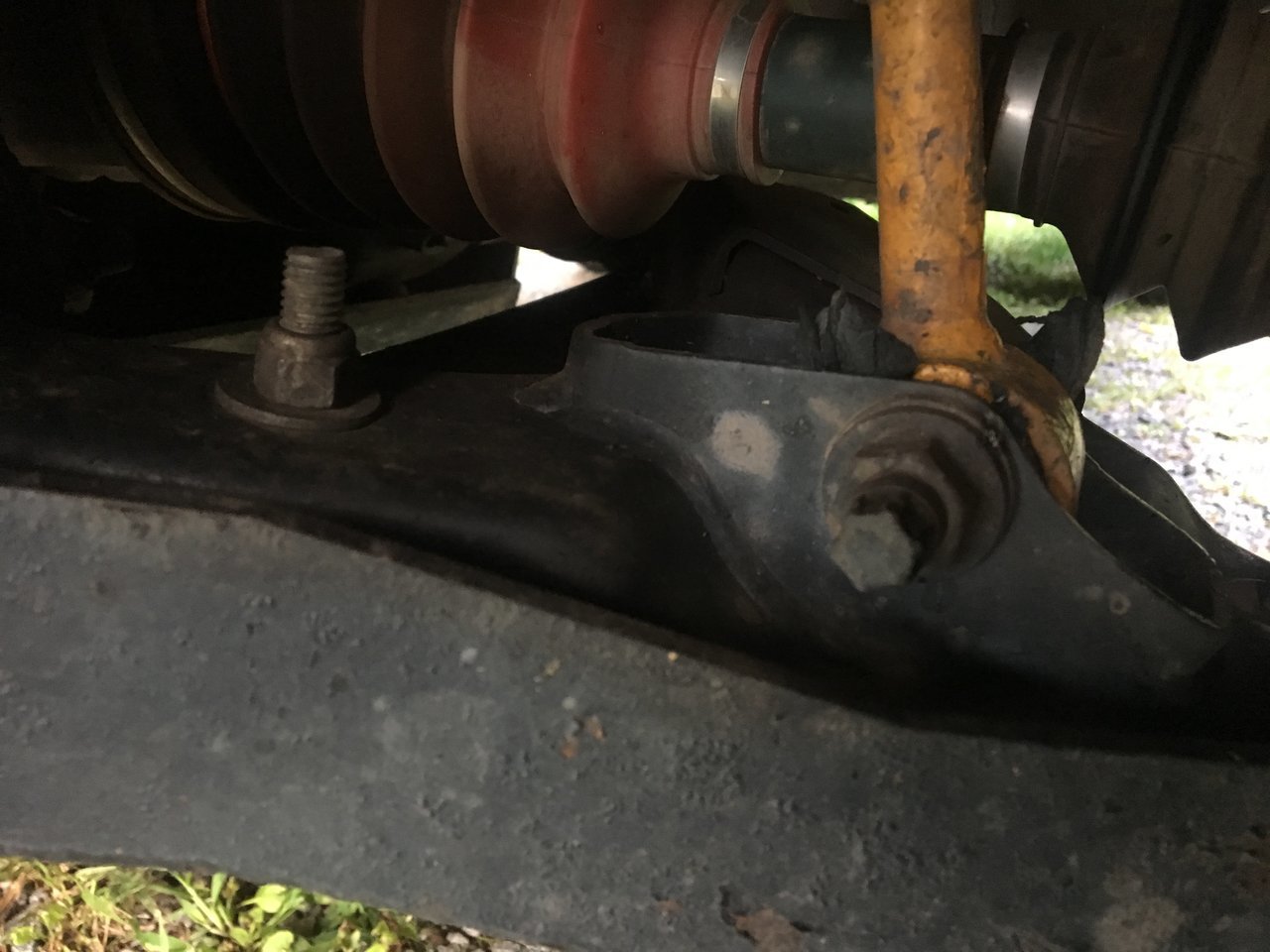

    Anyone ever replace this bushing?

    The shock eye bushing?

    yeah, the shock eye bushing blew out haha.

    I just drill out the rest of the crap and slot a new one in there.

    yeah, understand that part, not sure where to get a new one. from OME?

    I take ID and OD and width and go to summit.

    Smart! Thanks!

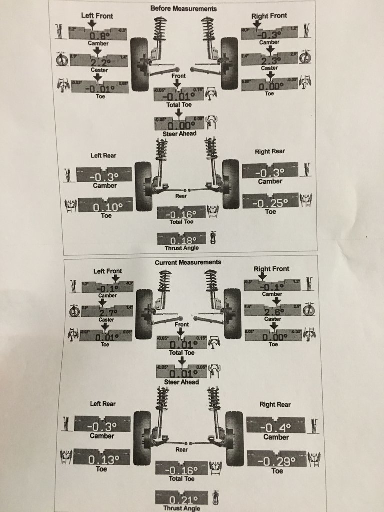

    Help! Truck going in at 2pm and need some last minute alignment tips from people with similar OME setup to me.
    I have a 2011 longbed with the following setup:
    FRONT:
    OME nitrocharger sport shocks
    OME 885 coils
    Toytec top plate spacers (1/2- 3/4in lift)
    Light Racing UCAs
    Diff drop
    REAR:
    Dakars in rear
    OME rear shocks
    TIRES:
    285/75/16 Toyo Open Country AT II
    I have read several alignment threads and still need some tips from those with similar lift to me.
    1. What should I aim for caster wise? With approx 3 in OME lift, LR UCAs, 33s some were saying around 2.4 degrees would be optimum caster while others recommended closer to 3 degrees.
    2. Is camber and toe at 0 degrees front and rear good for my setup? Just ask tech to get as close to zero on both as possible?
    3. What are people's opinions on techs setting slightly different specs from left to right to account for road crown? Should I ask for as even as possible both sides or does road crown adjust make sense?
    Thanks in advance!
    Andy

    Attached photo is what I ended up with today after alignment. Really happy with how it drives so far. On highway it tracks real nice and steering is very responsive with no wander or any negatives I can feel so far at various highway speeds up to 85mph. Gave tech what ballparks I wanted for caster, camber and toe. With LR UCAs they could have probably gotten more caster closer to 3 degrees, but I like how it is right now so far. Maybe next alignment I will find a better shop that specializes in alignments and shoot for a bit more caster. Gave him LR adjustment instructions. Only issue I have is he said he didn't do much adjusting at upper control arms but rather at lower arms. Does anyone see any issues with that?
    Camber and toe up front didn't seem to suffer as a result unless I am missing something...
    Not sure if what they did in the rear is good, but it's driving nice so that's a good sign!
