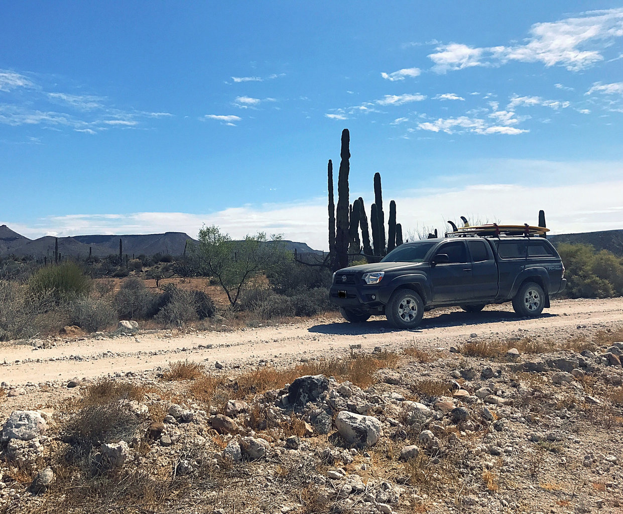

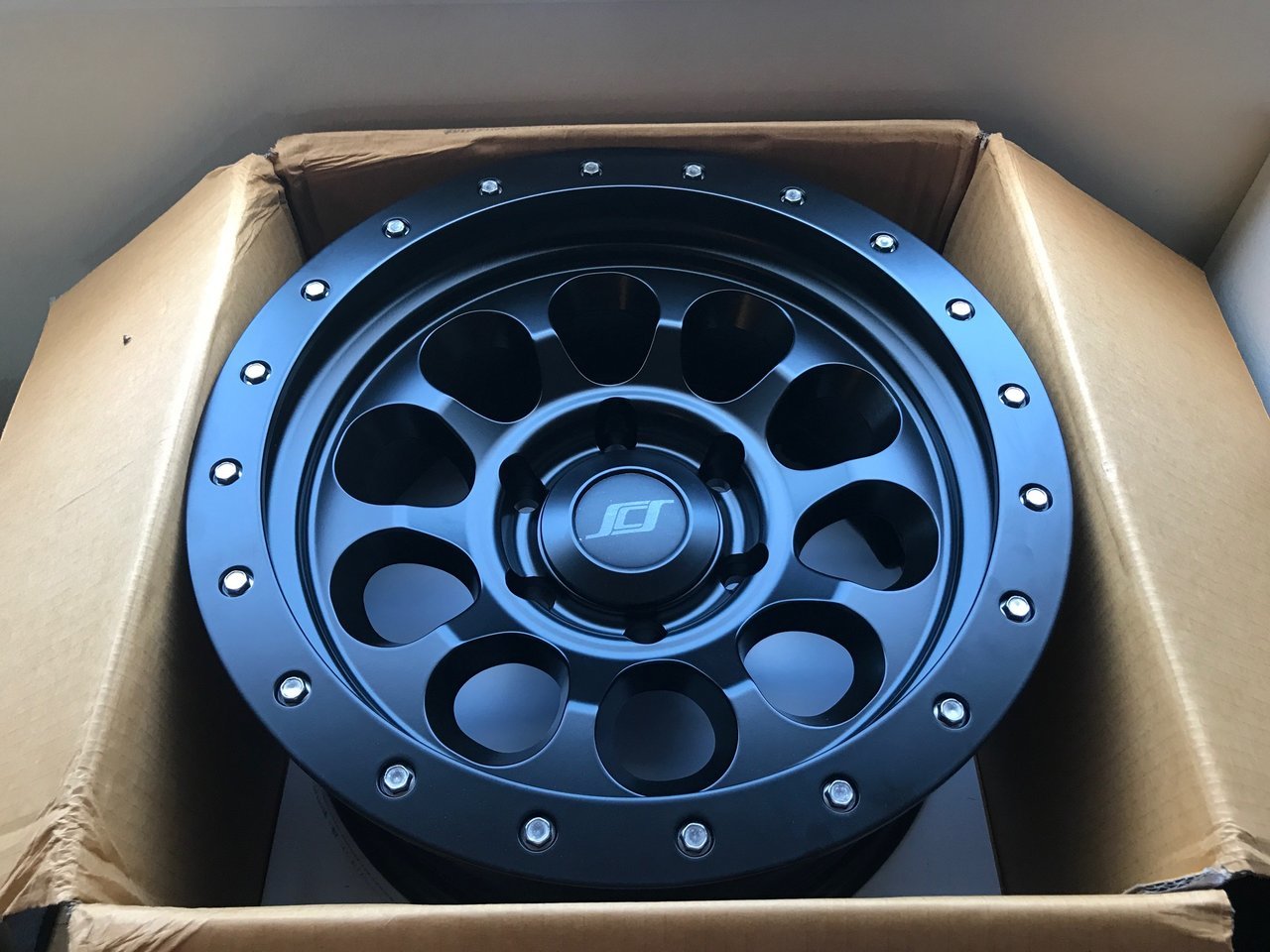

    Hi guys,
    I have a 2015 4x4 Access cab TRD Off-Road with a Leer cap. I recently was lucky enough to get the 16X8 SCS Ray 10s and in about a month I'll be purchasing 265/75r16 BFG KO2s (approximately 1 inch taller than my stock tires) and a complete OME lift.
    Here's a picture of the truck currently and the wheels:
    After doing a lot of research I decided that I would really like to stick to a 2 inch lift (or as close as possible) because I think that's what looks best proportionately with the tire size I'm going for. In reading this forum and looking at the Headstrong Off-Road website it looks like the best way to get the closest to a 2 inch lift with my setup is: Headstrong complete OME Kit with 884 coils, strut selection (not sure?), LR UCAs, Dakar light duty leaf pack.
    Do you guys with Old Man Emu think this is the best setup for me? I'd appreciate any input or recommendations. Thanks!

    You didn't tell us what you do with your truck. That would help.
    884s with 5100s gave me about 1.75" and a nice ride.

    I go on surf trips down to Baja and want to be able to make it to places that others can't for less crowded/empty waves. Mostly dirt roads with some rocky areas, silt beds and sand dunes. I also go up to the central coast to camp and the mountains to snowboard. Nothing too crazy, just looking for a noticeable increase in all around off-road capability over stock while still having a good ride on the road.

    884s and some semi aggressive tires should do the trick.

    I have original Bilsteins on my Baja T/X which really ran great with 265/75R16 Duratracs. For what you intend to do OME's basic lift and your KO2's will be more than fine. However, if you load down the bed you might want to do some cheap AALs. My truck probably looked more proportional and was far easier to maintain when it was this size. I now run 285/75R16 tires with about a 3" lift up front and who knows in the back. It looks like a need to go up to 35" tires...
