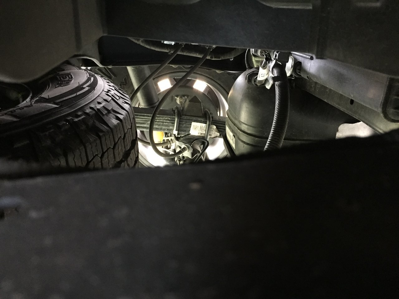

    Been running in my new OME kit for a couple months and have some vibration. It's not the needle bearing, yet. I got an alignment when I put on the new shoes and thought maybe it was a bad alignment job. It's slowly getting worse and I'm starting to think it's coming from the rear end. I looked at my bump stops and they aren't pointing straight up along with my U bolts. Could this be my culprit?

    Check your before driveline angles with your post lift angles. What's the degree of difference? Is it over spec now? I think spec is 1 degree.

    No pre-lift angles were taken to compare too. Does anyone have a picture to compare with mine?

    Lol. Well not taking pregame measurements will F you over good. There is a YouTube video of how to troubleshoot it. Let me see if I can find it on my phone.

    You can download an app then take measurements like the video above. One trick my friend at the Toyota dealer taught me was to use a socket on the u-joint so it gives you a little more room to work. I've used this method on my Jeep and it worked every time.

    I will see if I have enough light outside to check tonight. Thanks for the video, that explains a lot!
