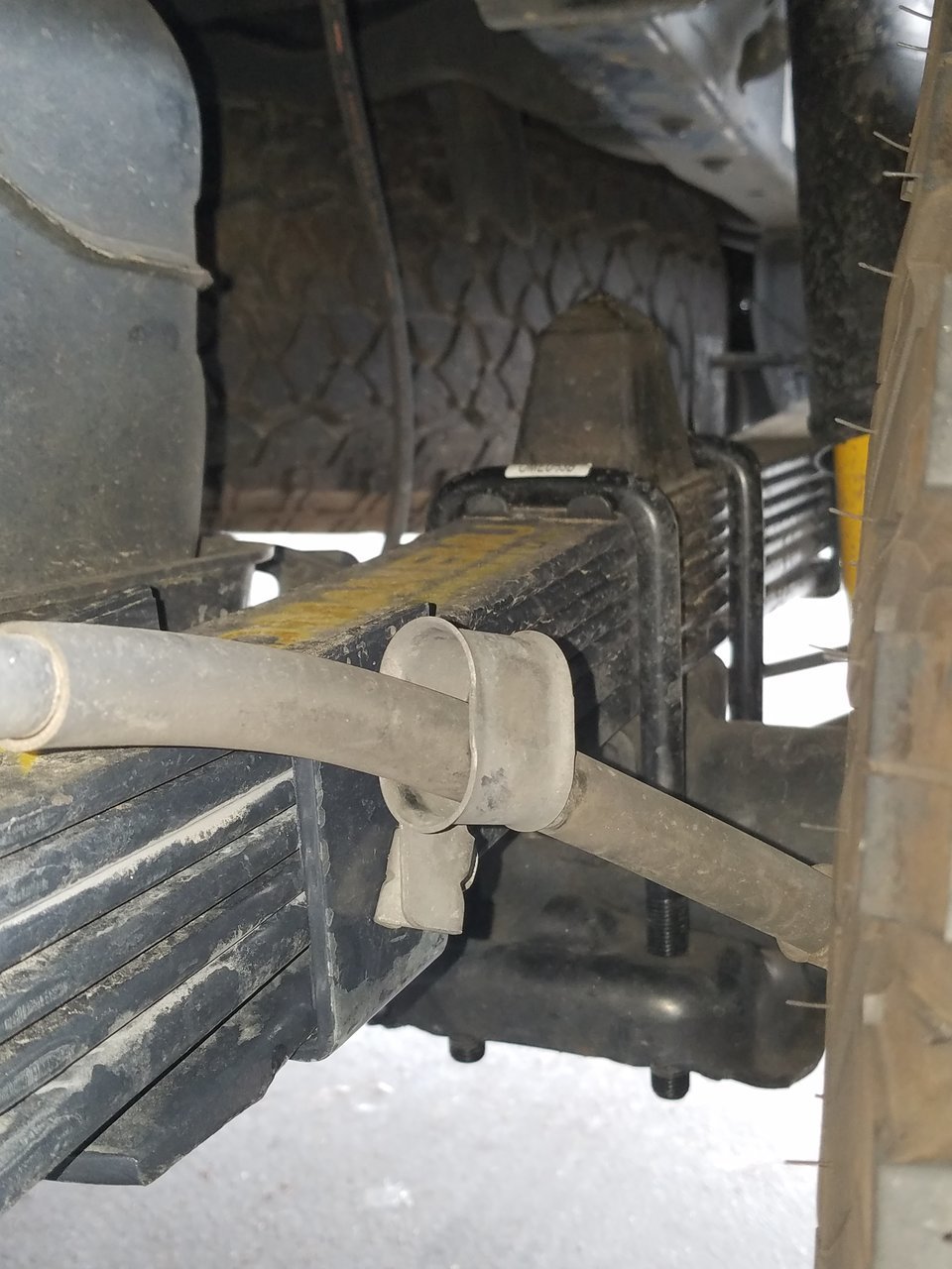

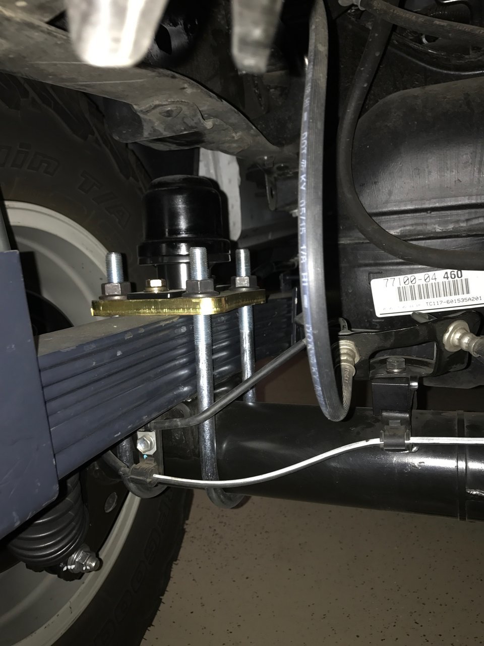

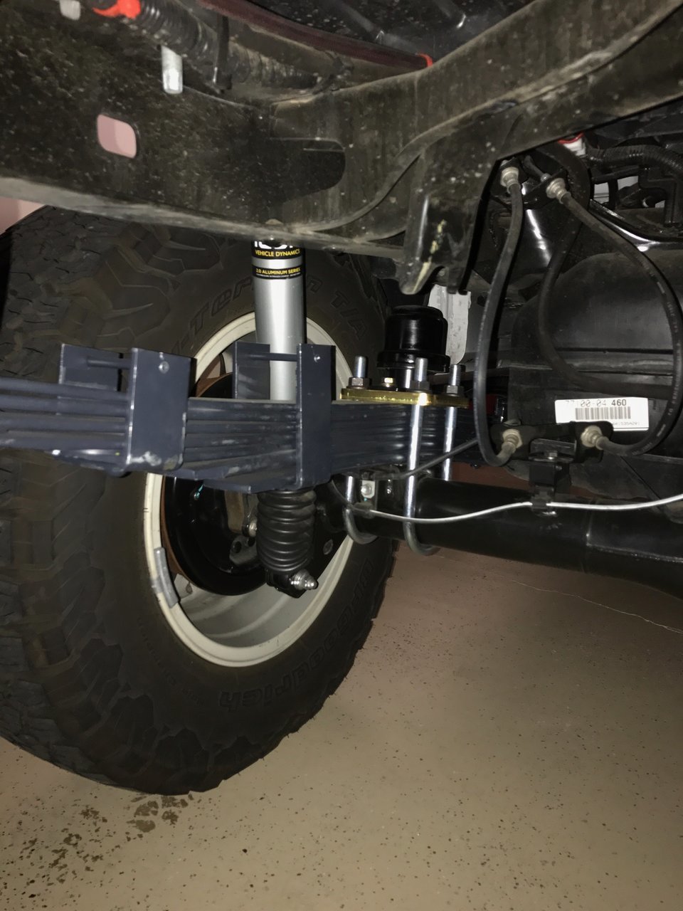

    Well you gotta be happy with that. Quick question. Do have have that wavy look with the LP's almost like a "W"? From what I understand the Dakars run flat. Here's mine with ~650lbs. Crappy pics but hopefully you'll get what I'm talking about. Thanks, enjoy your holidays.

    Ya mine have a very slight wave to them. Probably carrying around 550lbs at the moment. 20171224_140148.jpg
