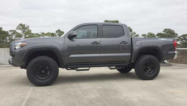

    2888 - Old Man Emu Coil Springs 90021 - Front Old Man Emu Nitrocharger Sport Struts (5mm Trim Spacer x2) 60091 - Rear Old Man Emu Nitrocharger Sport Shocks EL095R - Rear Old Man Emu Leaf Springs Total Chaos Uniball Upper Control Arms TRD Pro Grill American Racing 16" Wheels Falken Wildpeak A/T3W 285/75/16
    Satisfied. Took much longer than I thought to complete. Apparently UCAs weren't needed but ran them for good measure.
