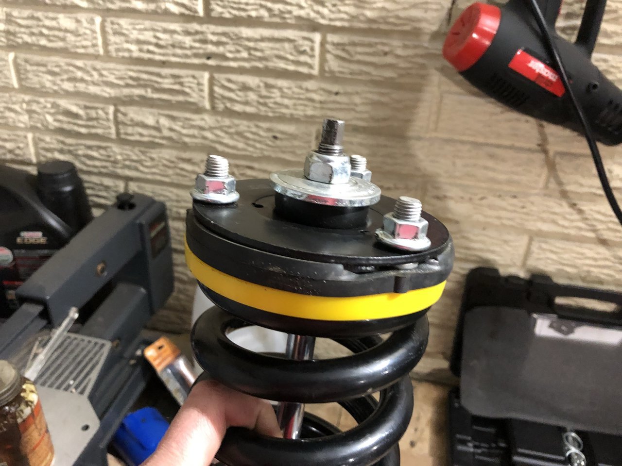

    Are extended strut studs needed for the 1/4 lean spacer?

    No. They're needed for any size greater than 1/4"

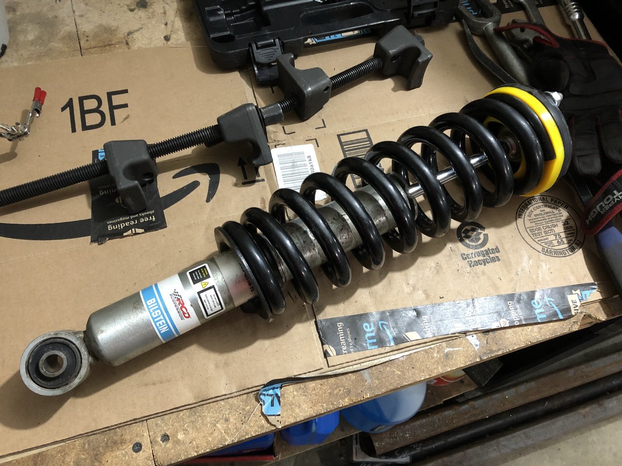

    What does anyone think of this? 5100 (lowest notch), OME883, new top plates with rubber, and OME JK trim spacers...should I leave the trim spacers off? 1st gen Taco, bullbar, winch, V6

    If you’re going with that much weight up front. Go with the 886 coils
