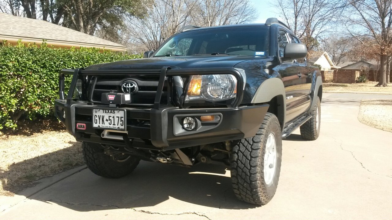

    I had been debating on whether not to go with 1/4 in spacers with 886/9000 up front. I have installed my ARB with a Warn VR-10000S winch. I think I'll leave the spacers out, but still swap to the 886/9000 combo. This pic is still with 887/5100s I think I lost less than an inch front after adding the weight. I didn't take measurements.

    What problems did you have with this setup? I ran that same combo for 40k miles without issue. Getting ready to go to 886s with the spacers since Ive added a s/c, winch, and front bumper.

    No major problems to speak of.
    I've only had the ARB and winch on since Saturday and just made few trips in town. I do notice body roll when going around turns (no sway bar). The 887/5100 actually hold the additional weight better than I was expecting.
    I've been running the 887/5100 combo for about 20k with no major extra weight and its been a great combo, but I'm installing 886s next week. I'm expecting about to get about same ride height I have now after the switch, but better handling.
    If you are wanting around 2in lift with bumper and winch, and still have a sway bar, then the 887/5100 combo would probably work ok. May nose dive a bit more while stopping.
    I just think that he 886 is the correct coil for my application. I considered adding the 1/4in spacer on top of the 886s, but I don't think I'll need it.
    *** I did have major problems when I had the 1/4 spacer on top of my 887 on the left side only for the lean, ate 2 cv's on the same offroading trip, the left side was drooping too far and the L cv would bind and fail, removed the spacer, accepted my fate of having a slight lean and no problems since***

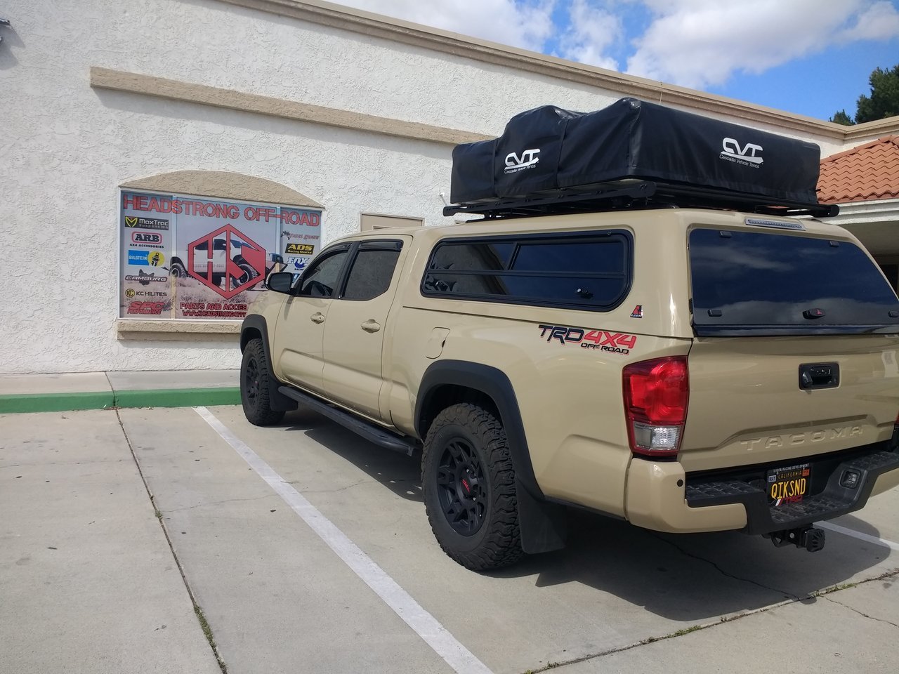

    Stopped by Headstrong yesterday and picked up a BP-51 kit with the HD Dakars. Last trip we went on it was painfully obvious we have maxed out the factory suspension. Hoping to install soon.
