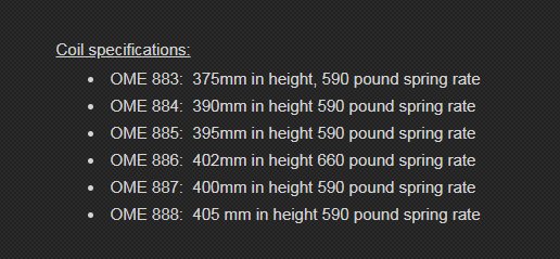

    I have some 620lb springs from Toytech (P/N: A/N 112-620). Since installation, I have lost a lot of lift due to the steel bumper and winch. I am considering the OME 886s to compensate for the added weight.
    Are the 112-620s from Toytech interchangeable with the 886s? That is, can I just buy the 886s springs and swap them out without any other parts/spacers/etc?

    Below are the specs from headstrong offroad, the 886 should bring you back based on the 660lb spring rate compared to your 620lb spring. with your after market UCAs you should be good but not sure if the 886 can go on the toytec strut?

    Yeah, that's what I'm having trouble confirming before I pull the trigger; whether the 886 will fit on Toytech strut. I may just end up giving OME or Toytech a call. I'm sure they'll try to sell me a whole new assembly though. Thanks man.
