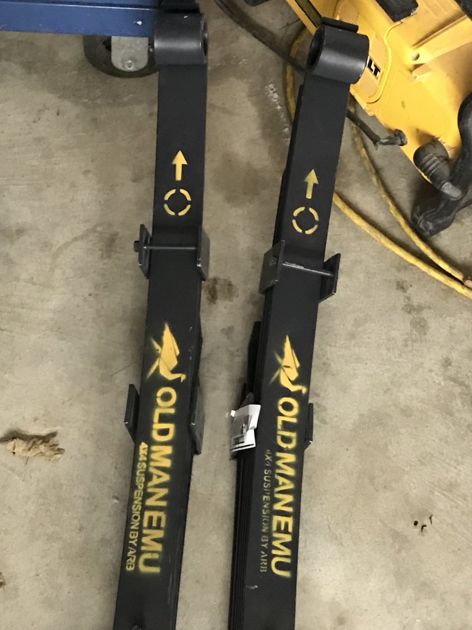

    Dakars look like mustaches when mounted (not arched like Deavers). Has your lift height changed much after settling? Adding the leaf will turn your medium pack into a HD pack. You can also add a leaf to a HD pack for heavy constant loads in order to maintain lift height.

    Looks like you really never got a confirmation on you question.
    Dakars should come with a "+", "0", or "-" marking. "+" = over spec, "0" = spec and "-" = under spec. So if both are marked the same just install. If marked differently, highest spec spring is mounted on the driver/left side.

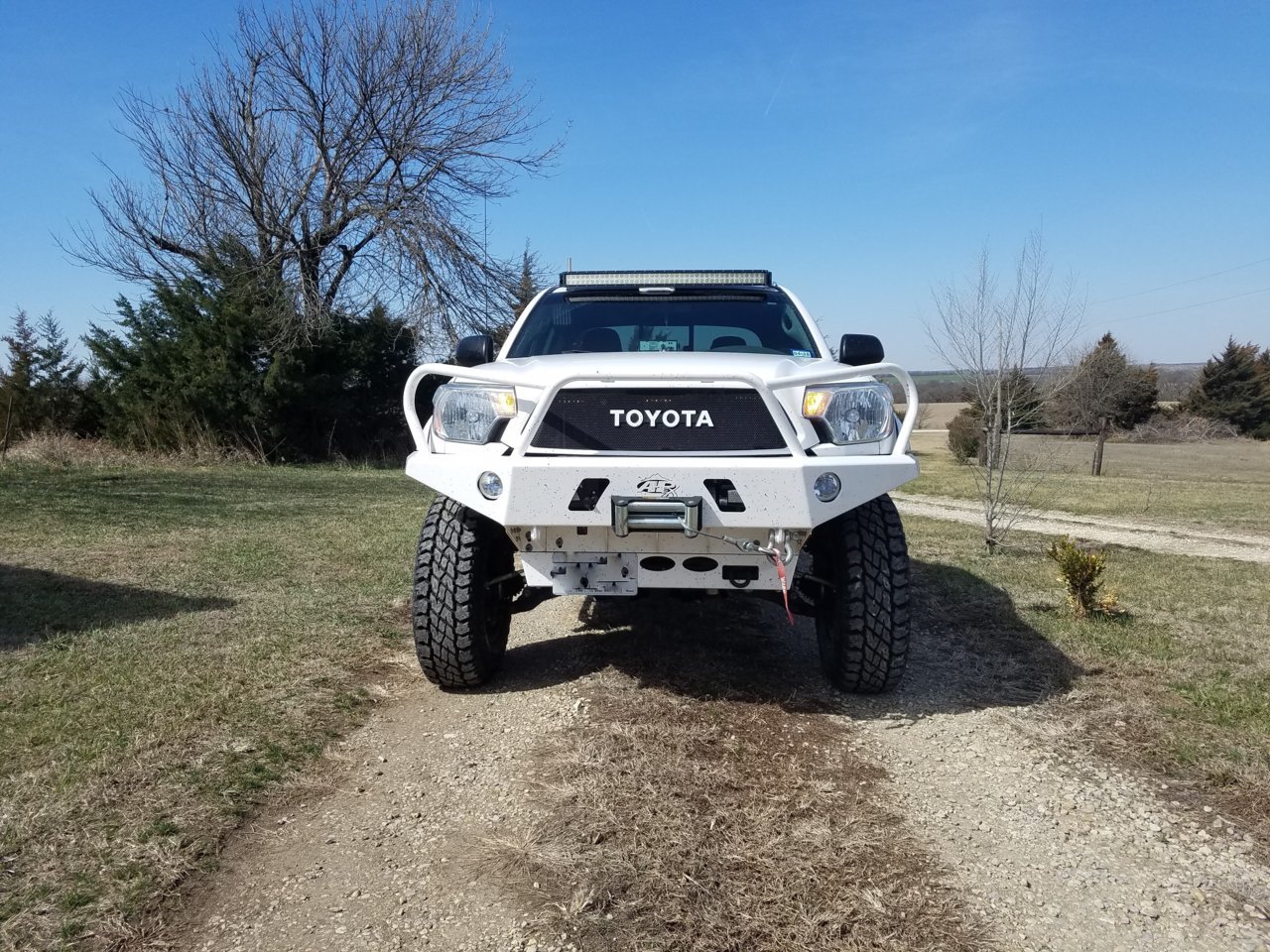

    So, the lift kit that I bought from Toytec awhile back actually came with 5100s. Hugo at Toytec was very helpful and said the 886s will fit fine, but that ARB recommends not pairing the 886s with the 5100s. I'm gonna give it a try anyway and see how it works out; can always make the change later down the road if need be. Also got the 1/4" spacer to fix the bro lean. $206 to get my front end back to where it was pre-bumper and winch and to fix the lean ain't bad at all. Thanks for the help guys.

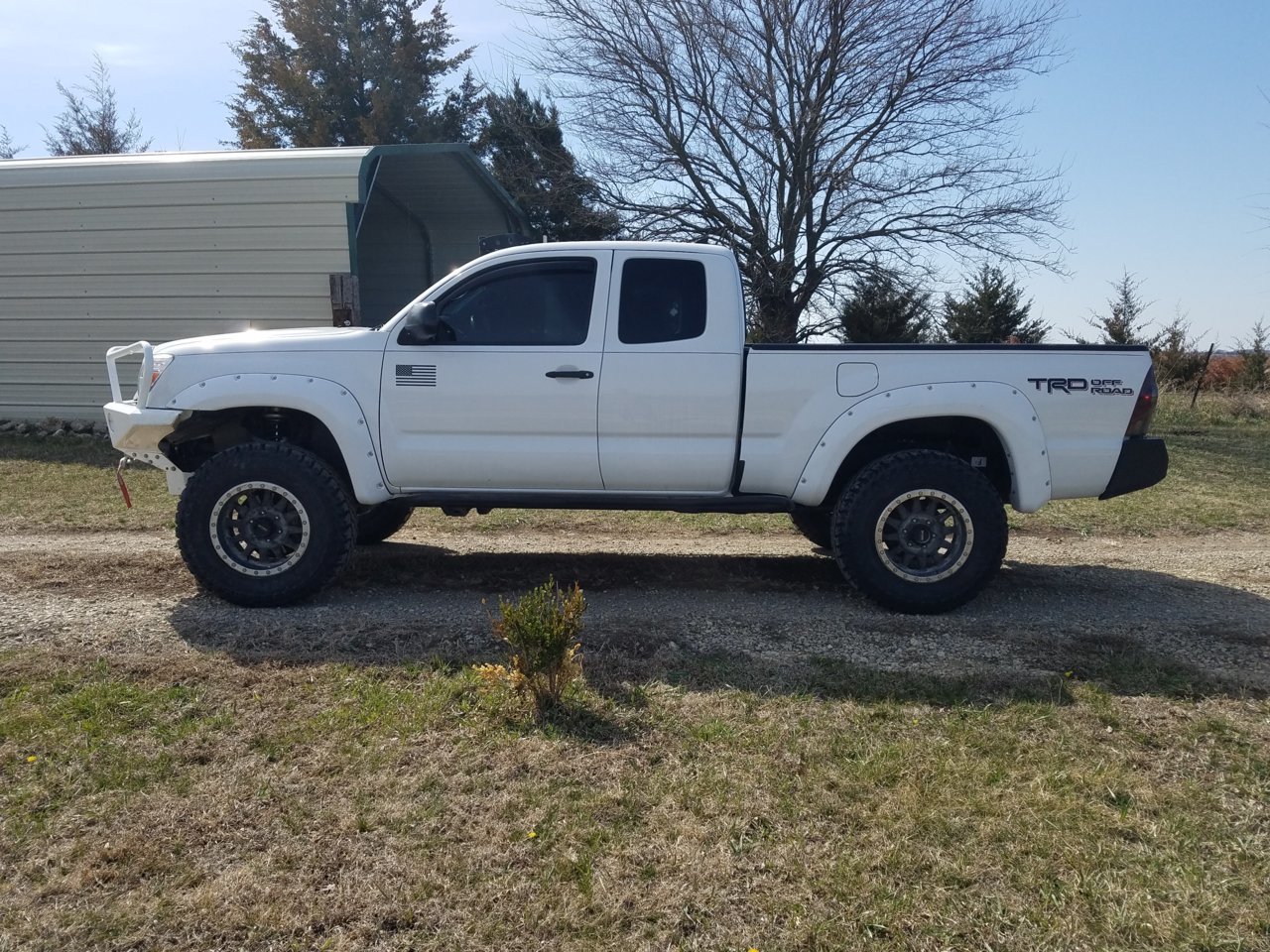

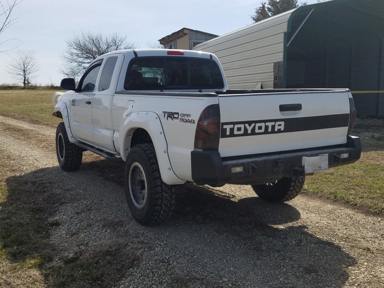

    Well, I got the 886s on with the 5100 Billies I already had. I think I got back the lift that I lost to the added weight. I think it may even be a touch more. I put some 255/80R17 Cooper Discoverer S/T Maxx skinnies on as well. She looks nice and level now though. My thanks to Toytech and OME.
