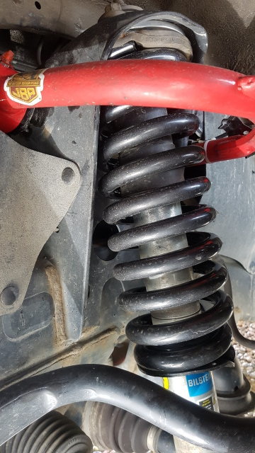

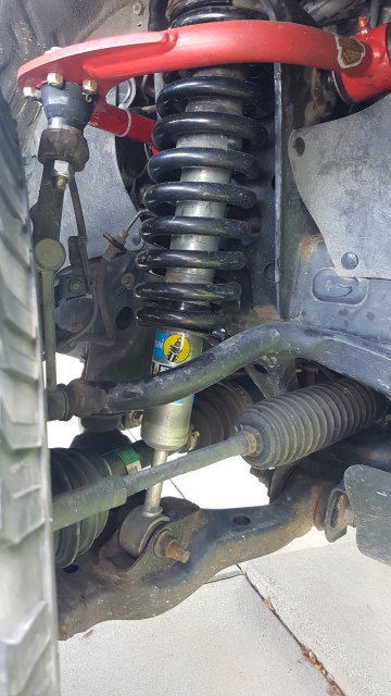

    Anyone know a reason why my 885s only got me 1"? 5100s on 0 setting 1/4" spacer on drivers, DCLB, stock bumper and skids.

    Post some pics of your front setup...

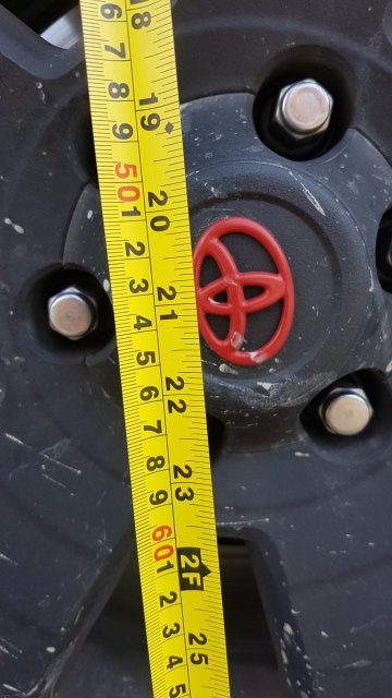

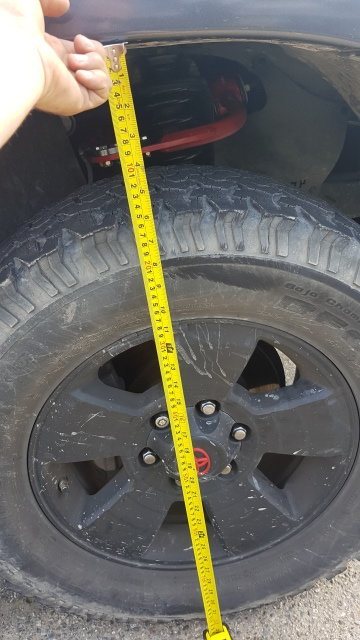

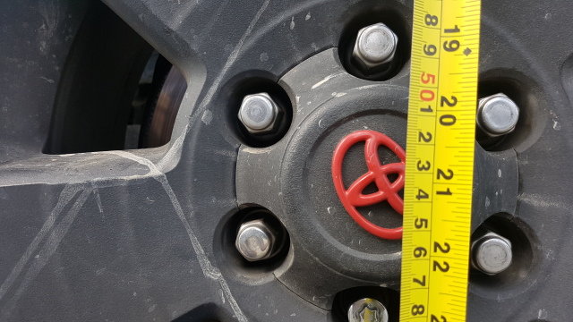

    And show us a pic of your measurement with a measuring tape so we can rule that out. 885's net more than that even after they settle.

    Best pics i can get right now, drivers side only. will post more after work.

    Passenger side
    Drivers side
    how i am measuring. To centre of wheel/hub

    I don’t know that you installed 885’s. Those are more like 883 measurements if your shocks are set at 0. Your pre-settled height should be north of 24” with 885’s. Where did you buy them?

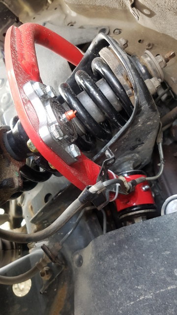

    So i just pulled out my 885s and they are the right length i believe
