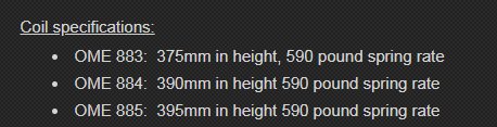

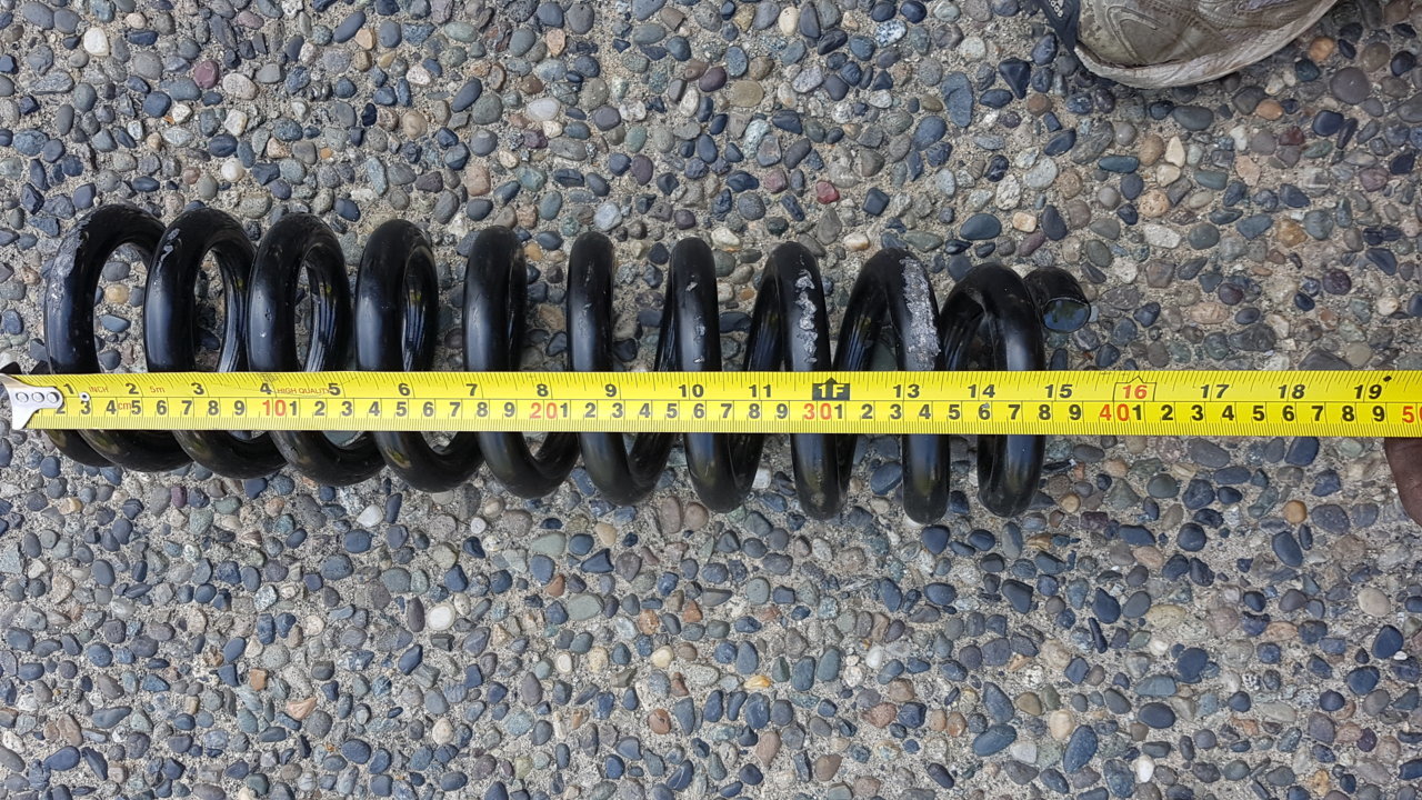

    Hey all, new member here looking for some advice from you more experienced folk.
    I bought a 2004 2.7l regular cab 4wd last year with 120k on it. Currently has 130k and has been rock solid so far. However, my suspension is still stock and starting to show its age. The ride is decent, but my rear leafs are flat at best and I feel my truck sits slightly lower than other similar tacos I see around.
    Here she is this morning:
    I don't do any crazy wheeling as I have open diffs and this is my DD, but I do live in Colorado and take it on trails occasionally so better offroad performance would be nice. I'm looking to get around 2 inches of lift all around, with some better support for the topper. I haven't done much suspension work but I like learning(especially if it means keeping costs down). The job looks very doable from what I've researched.
    I'm thinking OME all around. Dakar leafs, shackles, nitro shocks front and rear, and 881's. That should give me the 2 inches I'm looking for, without being so much that I need to worry about UCAs or anything.
    Will the cs046a/b leafs fit a regular cab? I know they fit xtra and dbl cabs, but can't find anything verifying they fit the regular cabs.
    Will 881's be too harsh with a 4cyl? I'd rather have a slightly stiffer ride than not getting enough lift in the front.
    Should I add an extra leaf for the added weight of the topper?
    Is the extended rear brake line necessary with this setup?
    Any other considerations? I'm looking to keep the cost around $1000-1500.

    If you don't want to get UCAs, 885s.

    Could be 884... But I'm sure your're measuring right.

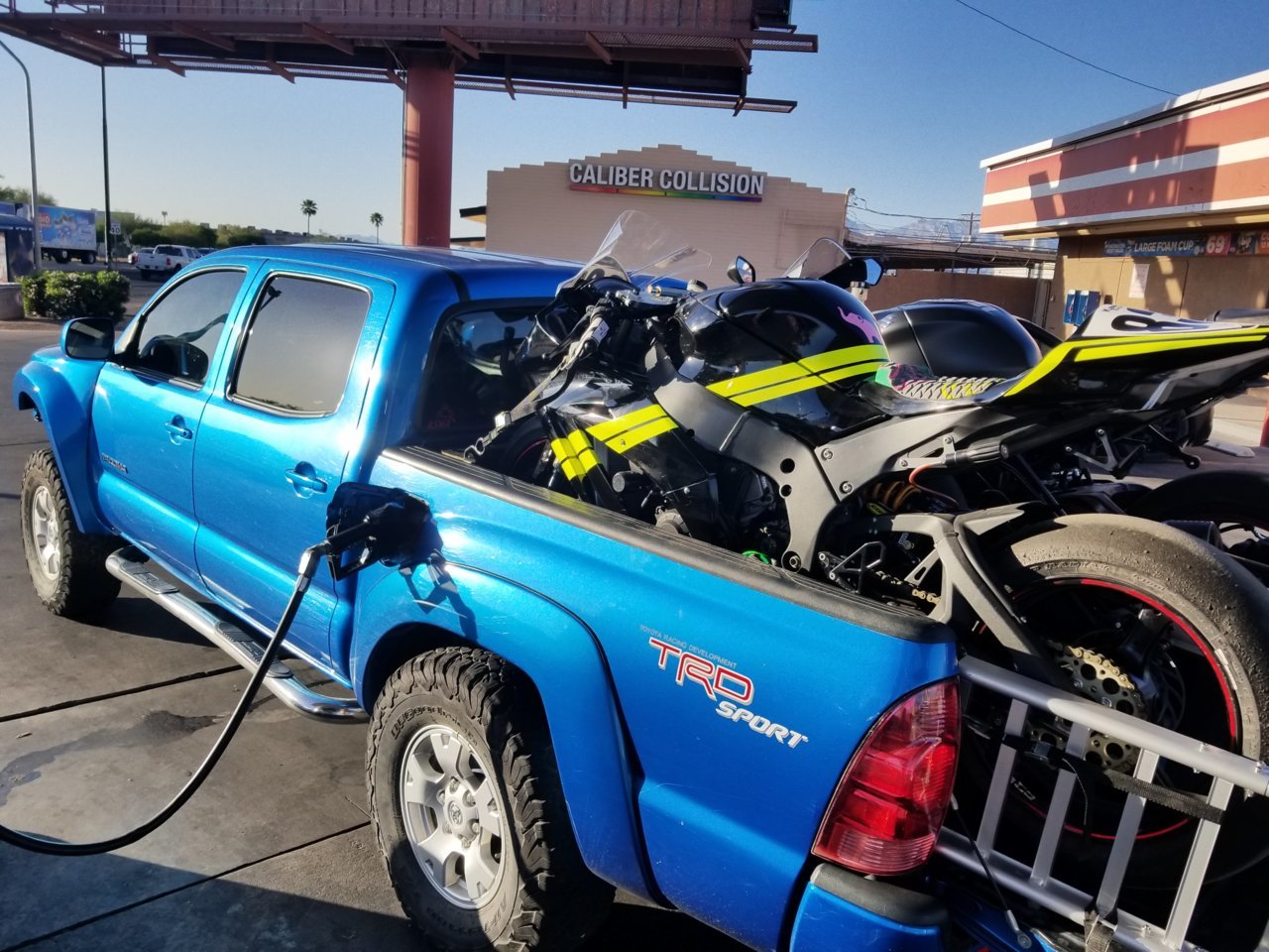

    I picked up some used CS047R springs for my 06, it has the additional spring (8 total leafs) I carry motorcycles (800lbs worth) pretty consistently & also have 0lbs in the bed all the time, should I remove one of the 3rd springs (3 & 4th leaf look the same) I also have ICON 2.0 resi in the rear which i think will support the lift provided.. Thanks for the help.
    (stock recall springs currently)
