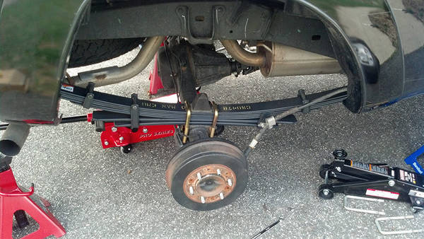

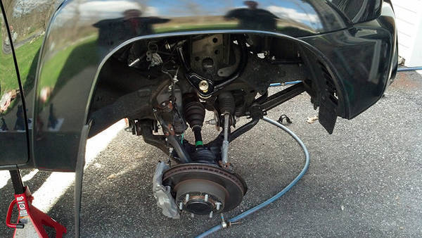

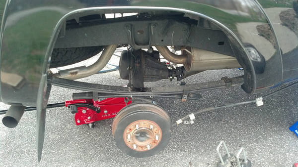

    OME 886x over OME 90000 shocks Front, OME N182 and Dakar Leaf Pack Rear, Light Racing UCAs, Pelfrybuilt Front Plate Bumper w/ Hoop, 265/75/R16 Duratracs on SCS F-5 Wheels, Redline Tuning Hood Struts, Weathertech Floor Liners
    Stock:
    Rear shocks removed, stock OR leaf pack (no TSB):
    New Dakar (CS047R) Leaf Pack:
    OME N182 Shocks:
    Front Shock/Spring Assembly Removed:
    SPC Light Racing UCA's (Yes, the ball joint is wrong in the photo, we fixed it later):
    OME 886X + 90000 Sport Shocks:
    Lift Complete:
    What did you put up front & what did you get?
    886Xs on 90000 Sports gave me 3". Driver's side is currently at 24.5"
    What did you put in back & what did you get?
    Unfortunately I was so excited to install the lift I forgot to measure. I think about 3" though. Driver's side is currently at 25"
    Are you running trail armor & how much lift did you loose or what did you do to regain/maintain lift?
    No trail armor yet, but the bumper and sliders should be coming within the month.
    Tire & wheel specs & rub or what you did to eliminate rub.
    Stock 265/70/16's here, so no rubbing. 265/75/16 Duratracs are waiting to be mounted on Stealth F-5's when they get here. Expecting no rub with the new wheels/tires.

    Looks like the adjustable caster plate is on backwards. Its hard to tell from the picture one my phone but it looks like the rounded side is facing the tire. The square side with the SPC logo should be facing the tire. Not sure what your caster would be set at with the plate facing the opposite direction.
  12. Apr 21, 2013 at 7:19 PM
    #1152
    bardicstorm
    bardicstorm Well-Known Member
    Aug 5, 2012
    #84155
    228
    Roger
    Morris County, NJ
    '12 AC TRD Off Road 4x4
    Yeah, it was. We fixed it after.

    It is backwards as far as the neutral ( +2* ) setting
    http://www.spcalignment.net/instructions/25470-INS_WEB.pdf
