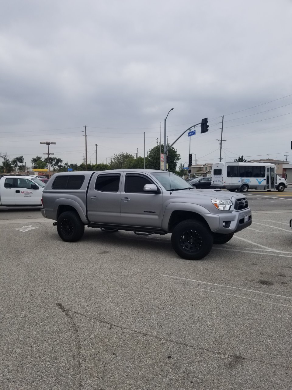

    Hi Paul. Great looking truck! Nice set up with bumper and winch! ( I'm considering similar set up next year.... mod money drying up, lol)
    With your hybrid bumper, I'd consider either 887x or 888x coils, and I would stick to 90021's . I don't believe you carry enough weight for 886x coils.
    UCAs are a touchy subject for many, but with 2" lift, aftermarket UCAs will help the ride (SPC or JBA are close contenders here).
    Don't add additional spacers besides DS trim spacer with your set up!
    You really have to figure out how much weight you normally carry in your bed to pick between 95r or 96r leafs... ( you could always add el46xl leaf if needed)
    I run T4r Pro wheels witn 255/80/17 ST Maxx tires. Those wheels stick out more than stock OR rims, and they rubbed on some plastics. If you're planning 285s, you'll need CMC....
    Edit: BTW, it'll look perfectly fine with 32" 265s. Especially on those rims!

    Thanks!
    I thought 5100s aren't compatible with the 886 coils. I was thinking of doing the 886s to compensate for my
    Yeah, I'm leaning towards doing the UCAs to do it all right the first time.
    That amount of rake is probably good I think.
    I think the 4Runner Pro wheels I have are -4mm offset so 20mm more offset than stock wheels. So I think they would clear 285s better than stock Sport/Offroad wheels but I'm definitely not 100% sure.
    Thanks for all of the help!
    Yeah, I wasn't sure if the HD would be too much. I'm probably around 300-400 lb. I figured HD would give me good wiggle room if I add more weight like a heavier topper plus food/water/gear and maybe even a steel bumper down the road.
    I agree with the soft-ride struts I think. That seems to be the consensus I've gotten.
    I think I'm going with UCAs after speaking with a few others. Do it right once! I was leaning towards LR mainly for the price on top of the lift parts. I'm also factoring in install costs from a TW members for help in SoCal and/or other recommended shops because I don't really have the garage/tools/buddies/know-how haha.
    In the bed, I have a ARE hard topper, bed drawers filled with camping gear and a 3/4" plywood top. I also have steel SOS Concepts sliders. I may swap my topper with a Go Fast or Vagabond Outdoors camper down the road. I'm also accounting for additional camping gear, food, water, and maybe even a steel bumper down the road.
    Yeah, I'm thinking of 285s down the road, not right away. I think I'd clear them with a CMC and mild trimming but will hold off. I'd love to find someone with an OME lift and the 4Runner Pro wheels to see their take.
    Thanks for the feedback!
    I know the 90000 are recommended but it seems a lot of people also run the softer 90021 and a lot prefer it
    I haven't heard anything about the shim you mentioned? The carrier bearing drop is included in the kit I thought and not something chosen separately.
    Thanks for all of the detailed answers!
    I love the bumper. I'd definitely recommend Southern Style Offroad's version.
    Hmm you were the first to mention not to do 886s. You think with the steel hybrid bumper, synthetic line winch, and steel front skid - that it's not enough weight? A bigger bumper down the road is an option but I'll likely keep the one I have because I really like it and the pseudo-stock look.
    I'm leaning towards doing the UCAs after all of the feedback I've gotten.
    Also, not planning on doing extra spacers now.
    I outlined what I have in the bed above. I'm trying to capture the weight on my truck now and what I may add in the foreseeable future realistically. I don't want to sacrifice ride quality though and I don't want crazy rake.
    You have the same wheels as me and you have an OME lift? The tires you have fit without a CMC and no rubbing? Those are skinnier right? Are they load range C or E? I'm trying to stay with C to reduce the weight and try to save some gas mileage. I don't tow or do any crazy offroading. I'm OK with a CMC and very minor trimming (trimming isn't preferred). I'd rather do neither if I don't have to though. I'm happy with my 265/70R17 tires but I wouldn't mind a little bigger once I add the lift.
    Thanks again! Marie at Headstrong has been great. I just figured I'd poll the audience as well to get some additional recommendations and thoughts.
