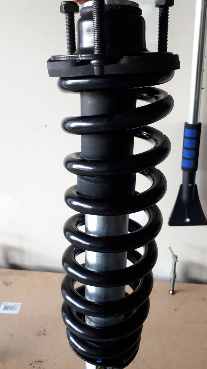

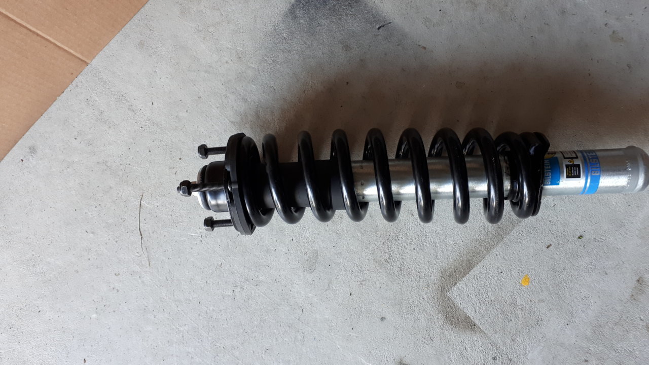

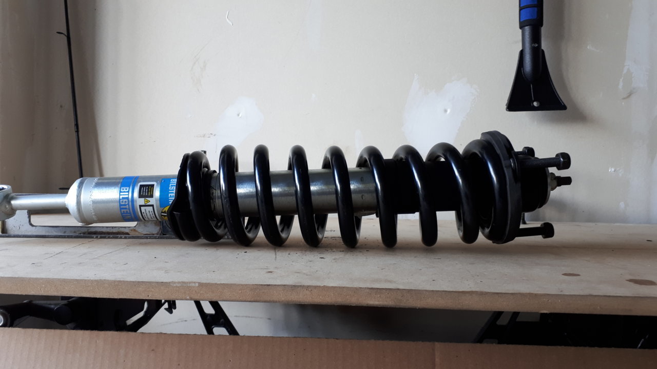

    Do you guys think this will straighten out once mounted. Double checked and theyre put together properly. Different angles looks like the spring is warped a bit.
    887
    5100
    Kyb top mount w/extended bolts20180531_165424.jpg 20180531_165331.jpg 20180531_164902.jpg

    No good, the strut isn't centered in the tophat. On the KYB tophats the lower retainer and bushing come preinstalled into the tophat, i think they are glued on and come off when you install the tophat and arent careful. Unfortunately you have to take these apart again.

    That sucks cuz i already took it back to the shop, had them take it apart to make sure the retainer washer underneath was sitting properly and it came out the same the 2nd time. I hate bringing shit back and dealing with them.
    Maybe ill rent a spring compressors and do it myself

    Do the no-spring-compressor method. Its perfectly safe and you will be able to center everything easily. For now you can reinstall your strut as is, then with the truck sitting on wheels take off your centre nut and top bushing and retainer. Then look at where the shock shaft comes through the top hat with a flashlight and you should be able to see the KYB lower retainer lip inside the hole in the top hat around the shaft.
    If the shop you went to used regular coil compressors (one on each side that get tightened independently) I bet they loosened one side too far before the loosening the other and this temporarily pulls the coil to one side and the lower bushing shifts.
    Been there done that. Mine looked exactly like yours.
    Its also possible that your shop assembled something wrong that your cant see, with the KYB top hats you dont need the lower bushings that came with the strut.
