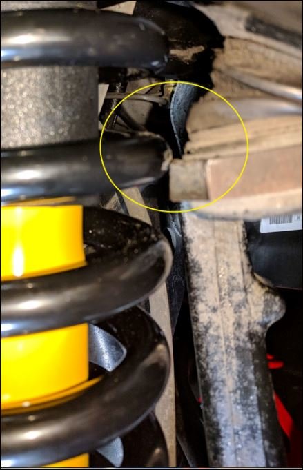

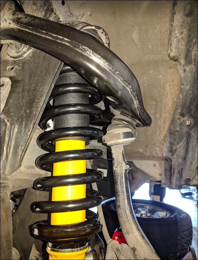

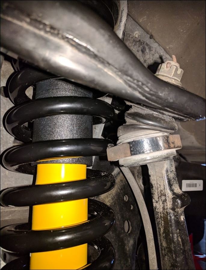

    So searched high and low but only found one so far with the same issue and no replies. https://www.tacomaworld.com/threads/based-on-these-measurements-are-new-uca’s-needed.514069/page-3#post-16221790
    Just put in 881s w/nitros (assembled by wheelers). LBJ's were also replaced. Noticed that the truck, while on stands and tires off (full droop), knuckle on the driver's side is rubbing the coil. Haven't yet checked with tires on and off stands. I did loosen the LCAs but did mark it and put it back as close as possible.
    Anyone else run into this? Kind of sux my new springs are scraped up before its even been taken off stands o_O
    Thx.

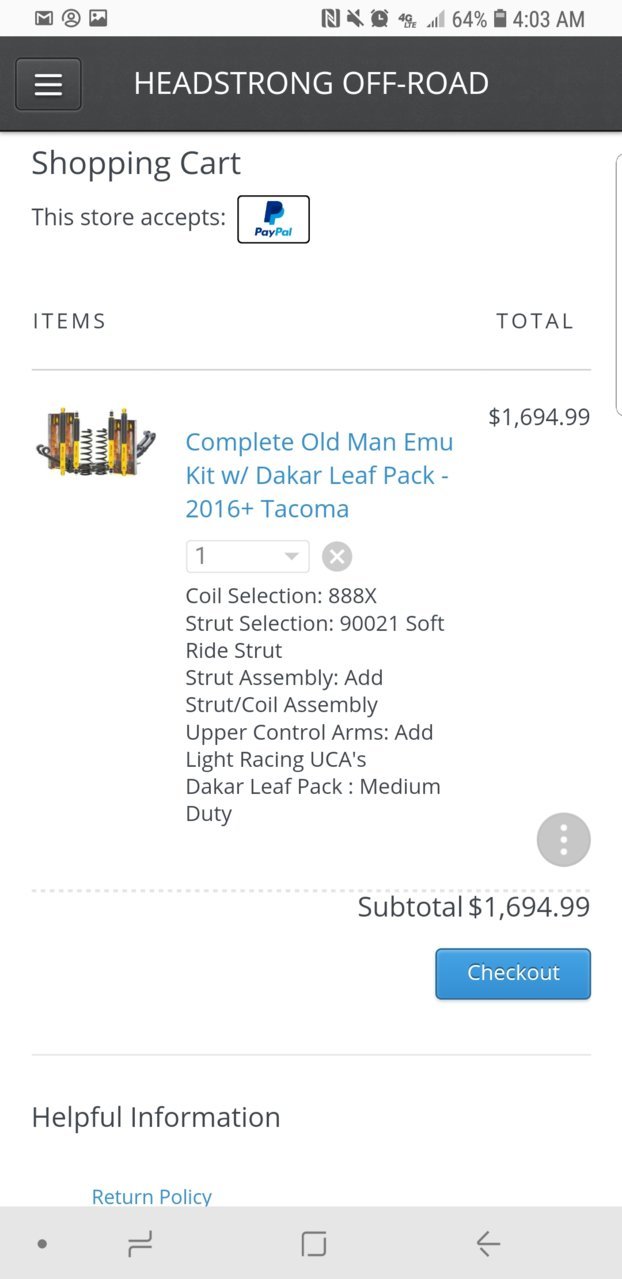

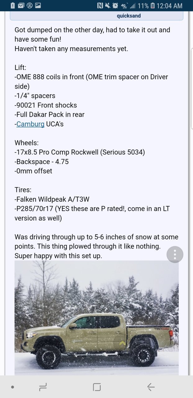

    So finally going to pull the trigger on the OME kit.
    Few final questions.
    1- I'm guessing uca is recommended on this since it has the 888 coil?
    2-can I add two additional 1/4s spacers to the front, similar to the setup attached and be ok ride height wise without added weight?
    3- should I go ahead and get the ECGS now? Also how long does this add labor wise while doing the lift if having it installed?
    4-want to run 275/70r18s on this setup. Should that be good to go without trimming?

    1. Yes
    2. I wouldn't run two of them.
    3. No, wait and see if it's an issue. It's easy to swap out.
    4. Probably not but you have a 3rd gen so I don't know for sure.
