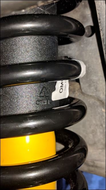

  15. Aug 7, 2018 at 9:32 AM
    Area51Runner
    Area51Runner Well-Known Member
    Jun 26, 2014
    #132748
    11,985
    Northern California, Bay Area
    02 3.4 DC TRD PreRunner 4WD SWAP
    not sure if its the same since as Headstrong but the OME coils I received from Wheelers have a white tag/sticker wrapped around the coil. like this -
  16. Aug 7, 2018 at 9:44 AM
    michaeln
    michaeln Old and In The Way
    Jun 21, 2018
    #257034
    52
    Michael
    Avery, CA
    2020 Cement DCSB TRD OffRoad
    No sticker on these. Installer probably took it off. I would have.

    360joules
    360joules FWC Stalker
    May 8, 2018
    #252951
    584
    Troy
    Portland Oregon
    SOLD
    I think that looks perfect, but I'm going for this stance. Wow, that looks good!
    If I recall, the numbers are actually printed on the coils in yellow (maybe not). Also, doublecheck your order to make sure you ordered 2887's. If you ordered from Marie, she may have some insight on the lift difference too.
