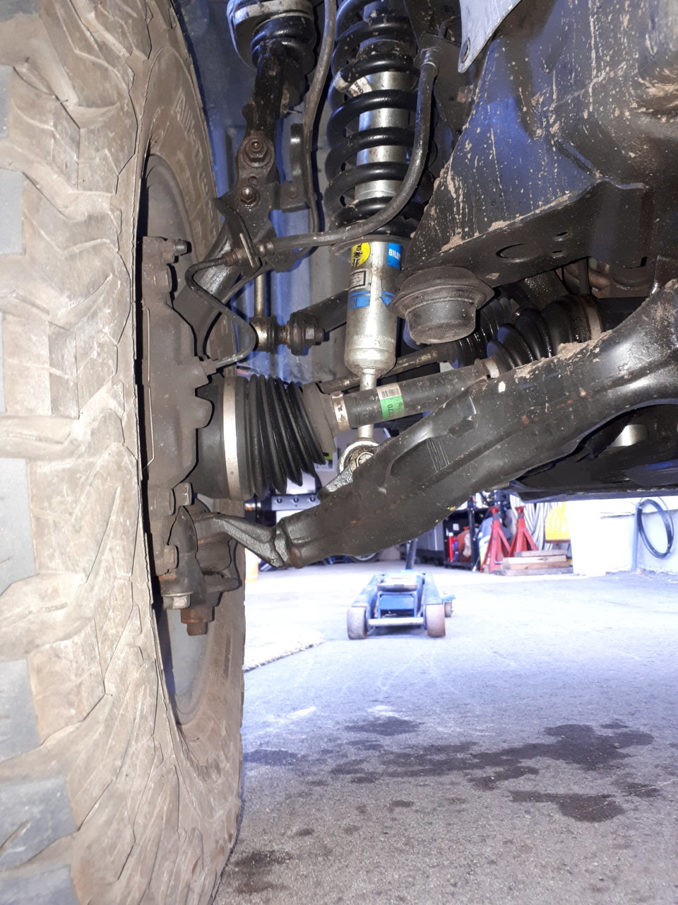

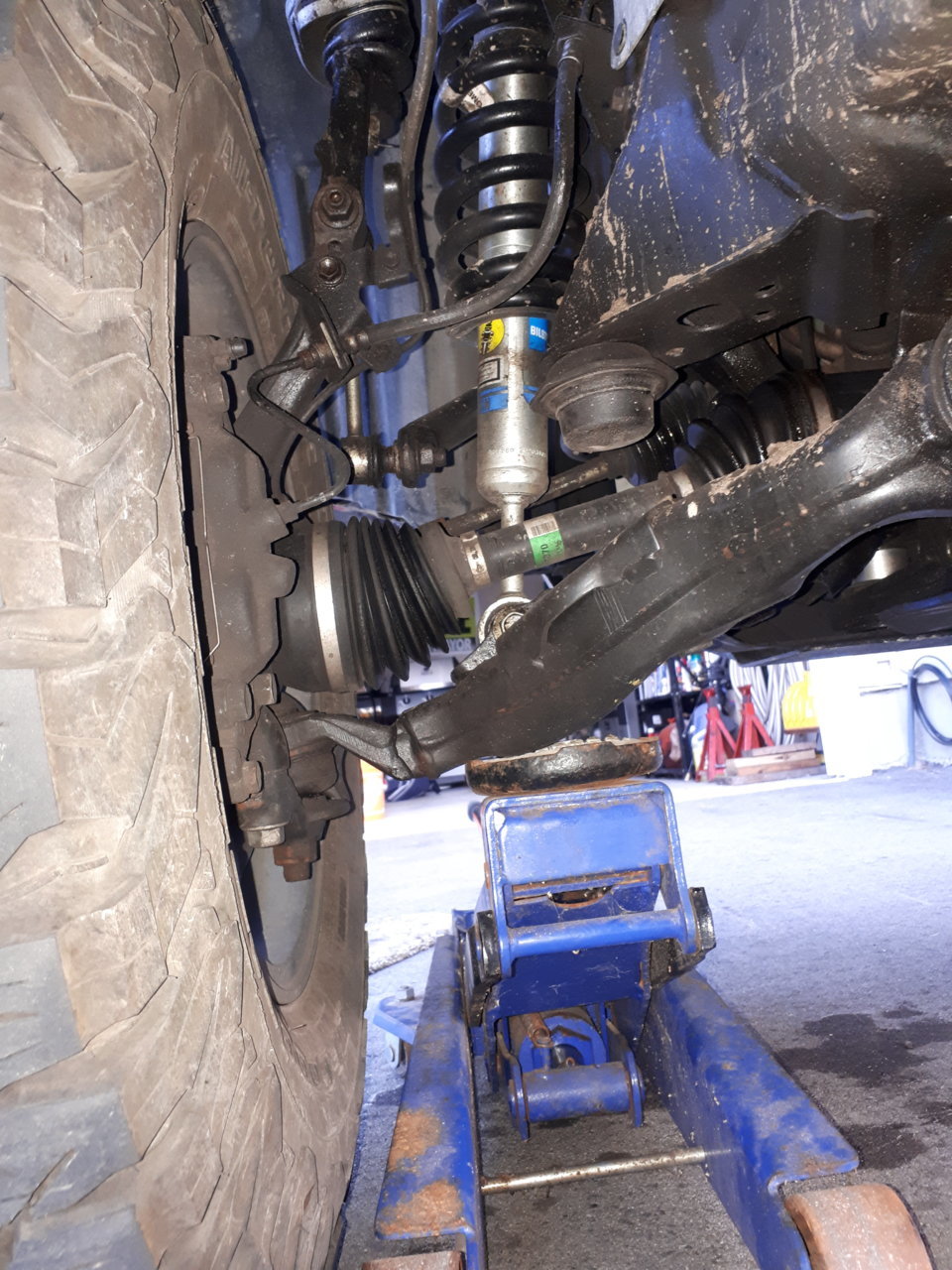

    Hey guys i installed 5100 & 887 but also added a 1/2" top plate to driver and 1/4" to passanger in order to push it up to match HD dakars better. Everythings fine, cv boots are better now after settle and diff drop
    But
    On some mild pot holes the front end bangs hard. Harder than when it was stock. Could it be my bump stops, or the shock maxing out its compression. I jacked it up from the lca and came nowhere near the bumps before the coil lifts the truck. Any advive would be appreciated
    Bump stop spacing with wheel on ground20180807_194455.jpg bumps with wheel lifted20180807_194335.jpg

    The springs will compress way more when it's on the road doing its thing but you knew that already. Try putting a gopro down there are reproduce the issue to see if it's the bumpstops. I'm not sure if they make them for 3rd gens but I like my wheelers superbumps. Affordable and they get the job done.

    I would assume the Wheelers superbumps would work. The third gen bumpstops look identical to the 2nd gen part.

    Those were my thoughts also. Ill find a mount and stick on under there. Wheelers bumps say 2005+ :thumbsup:

    Im gna stick a gopro under there and investigate. Also re-torque

    I did do mine yes. 2 days after suspension install. That was more of a mild rumble strip vibe tho. This is definetly smacking the bump stops or a full compressed shock. Not sure yet.

    @crashngiggles its not a clunk at all. Im using 5100 with the 887. Its a hard bang on the frame sounding like. Dont get me wrong its only happened a hand full of times not every day. But it never hit that hard on stock suspension going over the same pot hole probably. Girlfriends said nemerous times "i thought this was supposed to make your suspension better" blah blah blah lol

    You could be right. Never happened on speed bumps tho. Just pot holes.. Im 5100 also not sure if thats just an ome thing. Ill know this weekend when i stick the gopro under there
