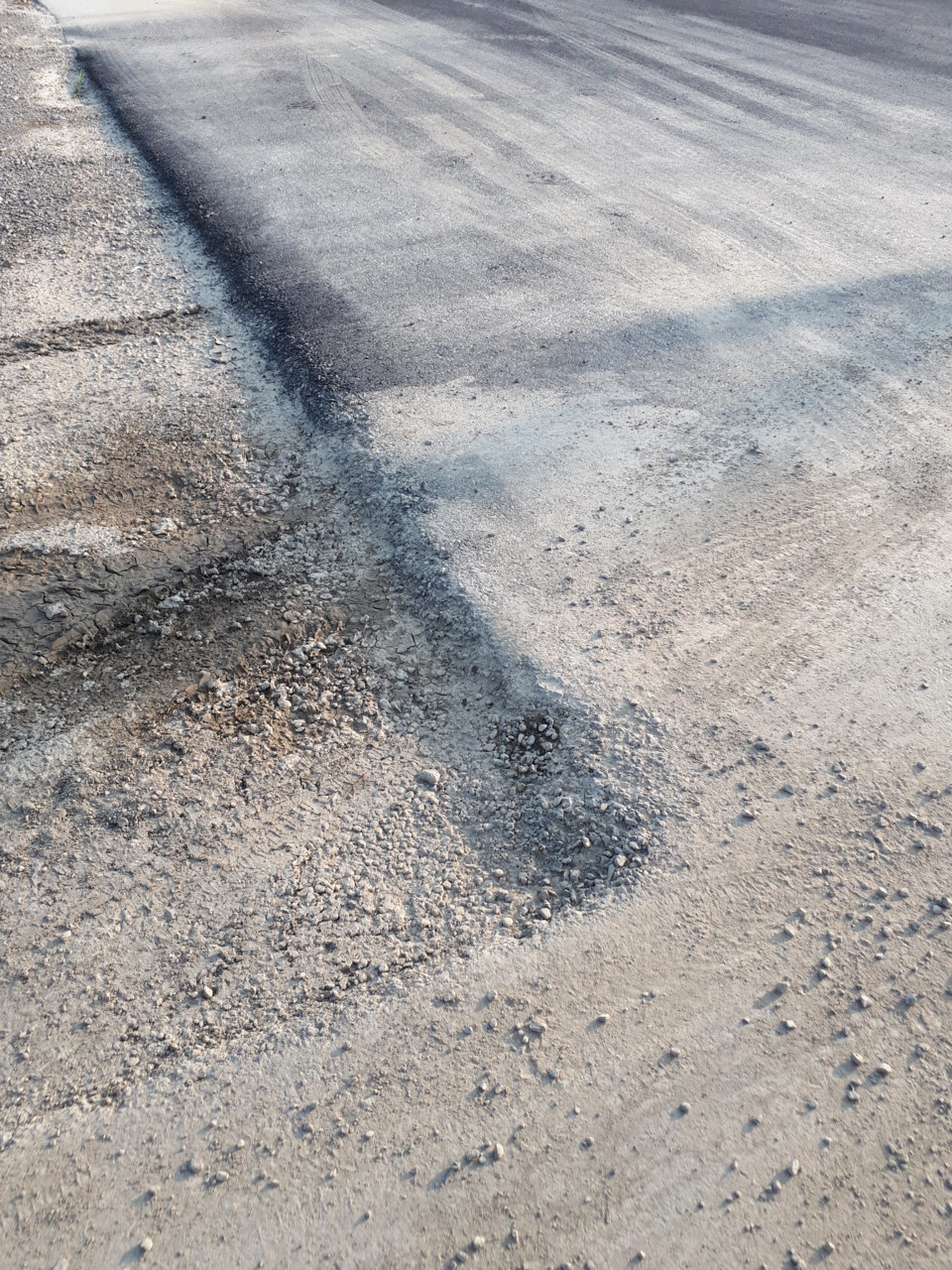

    So heres my taco clank, more of a smash to the frame. 5100/887 + top plate spacers.
    Only happened a few times and never on speed bumps, it absorbs those nicely and bounces back, doesnt bang. Only happens on quick incline drops/ potholes, not even that big. This is the little drop it banged off of to give you reference. If it happened every day id be more concerned.20180811_185521.jpg and this is how it sounds lol
    https://youtu.be/BgO6UJu9m4o
    And it didnt contact the bump stops. I put a bunch of chalk on it. No contact or rub marks on sway bar or coils. Makes me think its a quick over extension bang, or quick fully collapsed bang. I dont know. Rides awesome 99.999 percent of the time

    I didn't watch the video because I'm out and about but do see you have a sway bar. Any chance its contracting that? Maybe check for impacts marks or take it off and try to reproduce the noise.

    I was under there today re torquing everything any theres no contact marks or rubbing anywhere. I didnt take the skid plate off and inspect the whole sway bar tho. I could take it off tomorrow and try. Good idea

    Usually it contacts the coil if it hits anywhere so if you didn't see anything that probably isn't it. Thought I'd mention it though.
