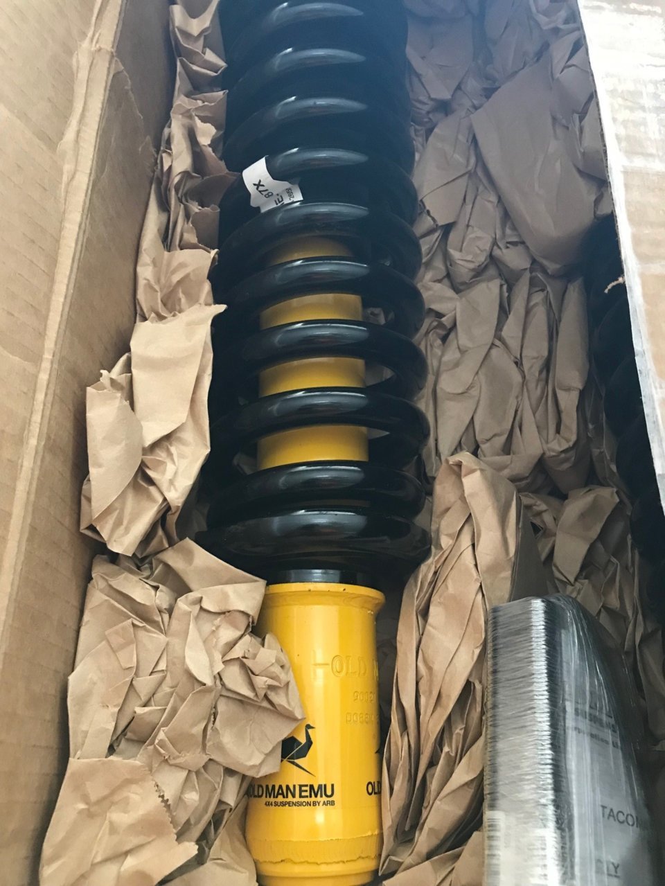

    Ok... been a tacoma owner for a long long time. Ran the Icon stage 2 extended travel system on my 08 for years. Just switched to a 2018 and bought the OME Kit with the sport shocks and 887 coils. I work a LOT in Australia, Borneo, PNG etc and everyone there runs OME shocks and its considered top of the line. So my question is...
    Why do you guys run 5100's on the 887's etc over the OME shocks? What is the issue the Tacoma has with the OME shocks?

    I have many people who go back and forth between the Bilstein 5100’s and the OME’s. What typically differs from the Bilstein 5100 kits and the OME kits is the shocks themselves. Most of the other components stay the same (some of the coils and rear lift options). Since this is the case I find it helpful to compare the shocks side-by-side, this way you can see which ones would be suit your specific needs.
    Some of the differences between the OME nitrocharger sport shocks and Bilstein 5100 shocks are below:
    Bilsteins are a steel body that has been coated with their triple-C coating which seems to hold up better in the elements the powder coating that OME’s has on their steel shocks.
    There are two different OME struts available the standard 90000 which are the firmest and the 90021 soft ride struts. The Bilsteins fall in the middle as far as valving is concerned.
    The OME’s have a slightly larger shock diameter then the Bilsteins.
    The Bilsteins are a monotube shock and the OME are twin tube.
    The Bilsteins can run the OME coils but if you wanted to run the OME 886, for weight either now or down the line, the 5100’s and those coils are not best paired together. If that were ever going to be the case with your build then OME would be a better fit.
    The OME shocks have an internal component which can be noisy at times. Some people refer to it as the “speed bump clunk.” The Bilsteins do not have this same component design.
    The OME rear shocks will work the Dakar pack and not require bump stop modification or longer brake lines but they limit the amount of droop you see from the Dakar leaf pack. The standard length Bilstein 5100’s really should be used with one of the add-a-leafs or a block up to 1.5”. The extended length RCD/Bilsteins will also work with the Dakar leaf pack but longer brake lines are needed and possible bump stop modification but you get more droop from the pack.

    Awesome answer. Isn't the OME shock stronger too? I'm looking at my 90021's and they appear thicker in every aspect. I guess I just don't understand why anyone would go with the Bilstien when the OME's seem to me at least better in every aspect.
    Never have I been truly happy with ADD a leafs although "wheelers 3 leaf HD pack" was amazing with my Icon lift. Just went the the Dakars this time and going to limit myself with the OME rears. Rambling I know. Just don't see how the 5100's are better in anyway other than the option to change the spring mounting but that can be compensated for by buying longer coils and you have to take them apart anyway to change out the cup location?

    yes they are stronger and they are nitrogen charged unlike the 5100s

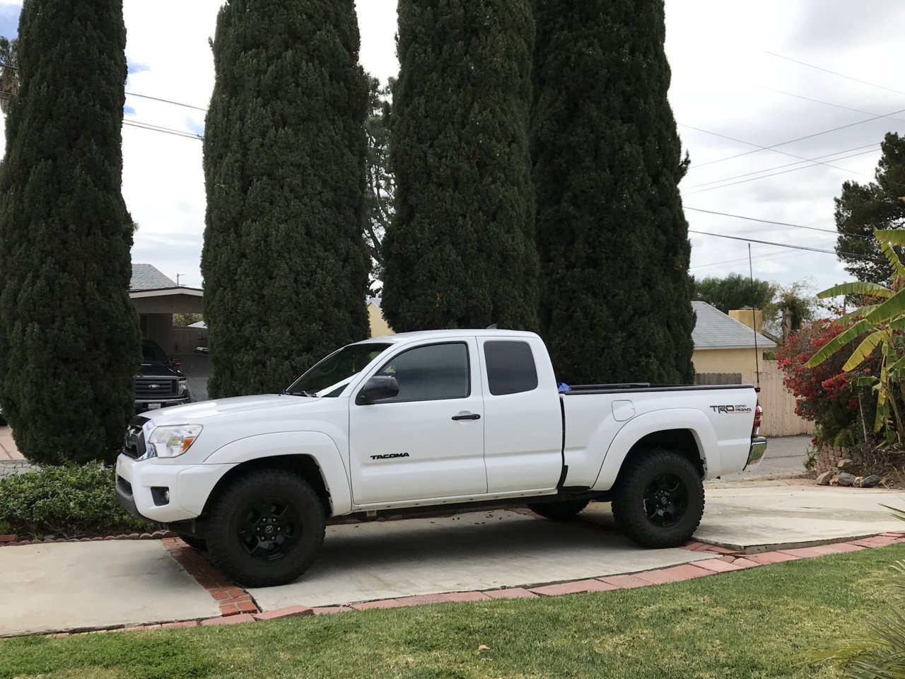

  16. Aug 12, 2018 at 4:58 PM
    huck123
    huck123 Well-Known Member
    Nov 14, 2017
    #235988
    101
    Hunter
    Butte, MT
    2005 TRD OR Access Cab
    3" 33s, UCAs, Hurst Short Throw, JL 12 500 Watts

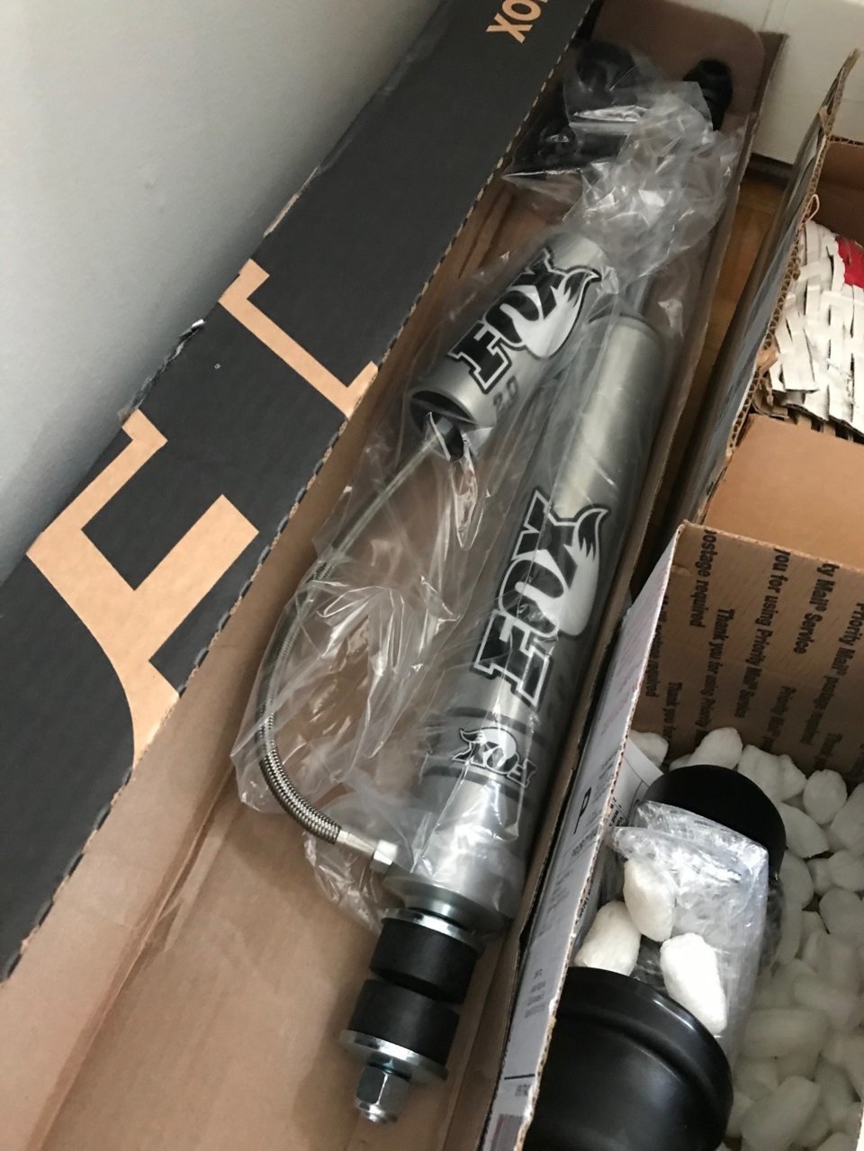

    like my picture showed i went with the extended fox 2.0 in the rear for full droop too. gonna be busy installing all this when the weekend comes front and rear shocks, dakars, ECGS bushing, bumpstops, brake lines, lower control arms, upper ball joints.
