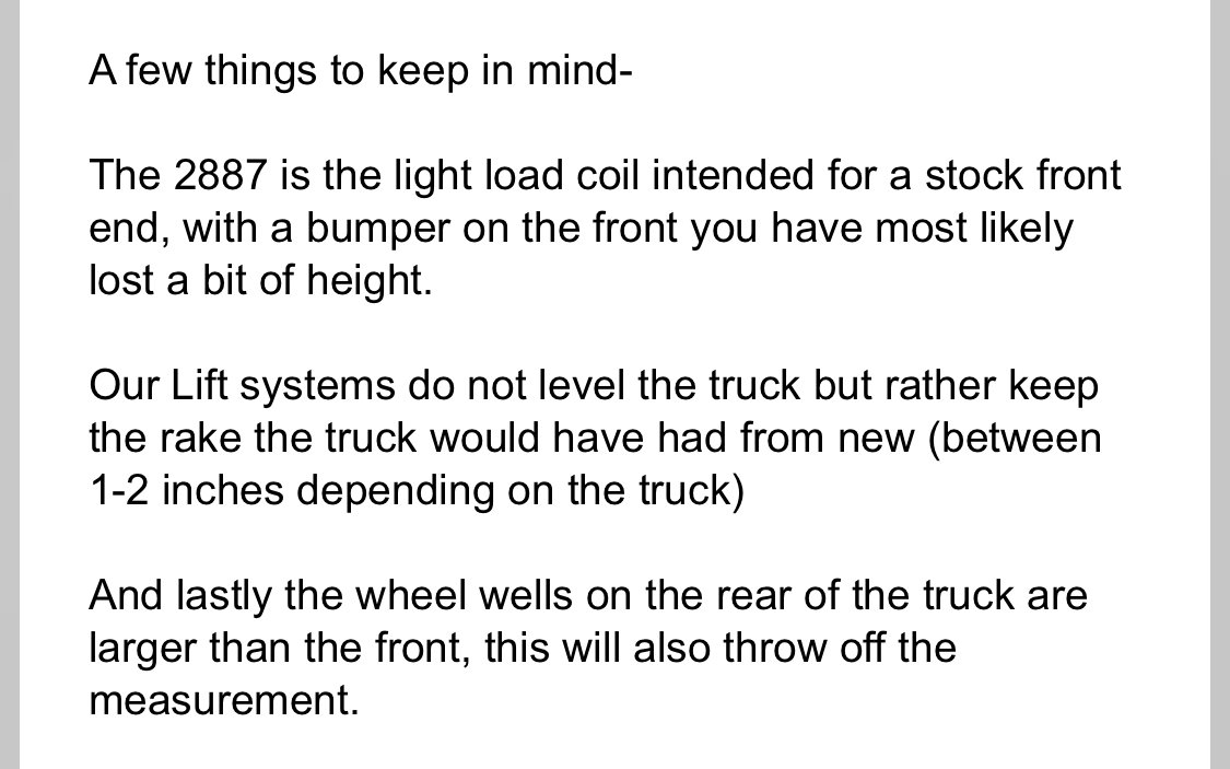

  20. Aug 20, 2018 at 11:54 PM
    pr0b
    pr0b Well-Known Member
    Mar 12, 2013
    #99569
    298
    San Jose
    '16 DBCLB Off Road Magnetic Gray
    CustomCarGrillz Grill OME lift kit Demelo Off-Road sliders De-badged 305/65/17 BFG KO2 Prinsu Cab Rack SCS Ray 10s SDHQ Behind the grill LED bar mount Baja Designs 30" LED Bar Rigiid Industried 30" LED Bar Magnaflow exhaust MESO map and dome lights Expedition Essentials TPAM VLED switchback front turn signals
    I just contacted ARB for the exact same reason. The rake is very noticeable.
    I’m attaching a screen shot of their email reply.
