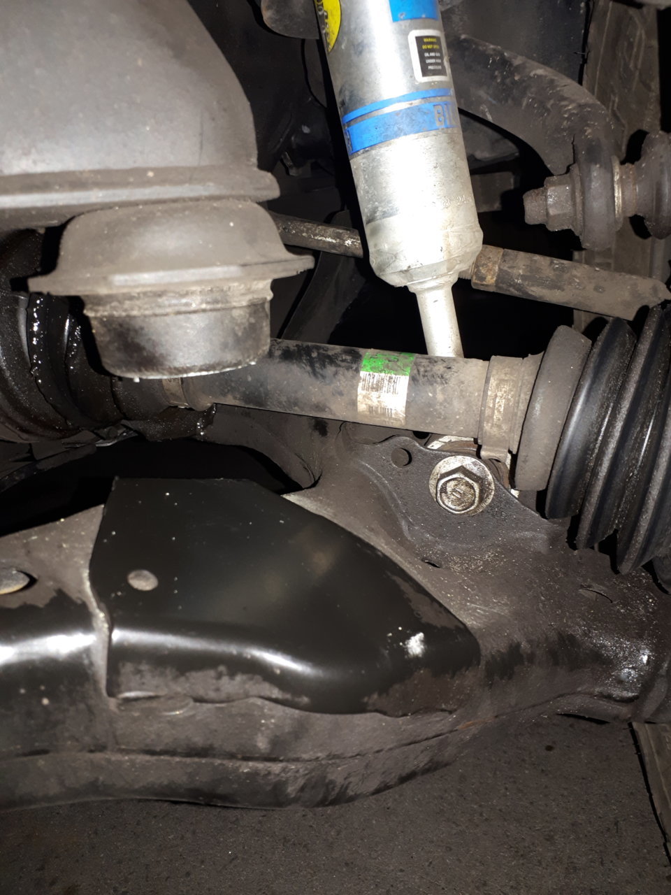

    That last photo makes me think that you have a torn cv boot.
