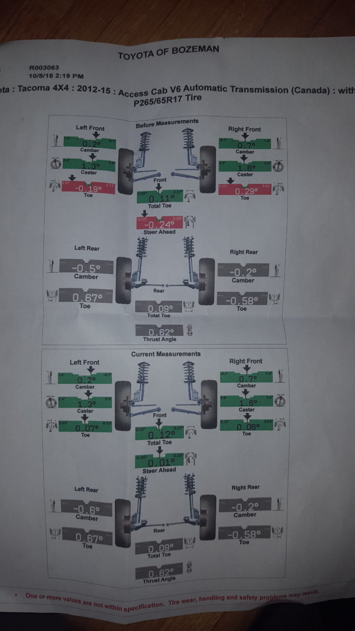

    Here is the print out of the 2nd alignment, I don' think caster is as high as some have recommended. Also they had 265/65 tire listed when I'm on a 255/80. Still pulls hard right, not as squirrelly but not great.

    Might help to include what you’re thinking for the rear also. How much rake you’re considering.

    I'm no expert but those don't look like great numbers.

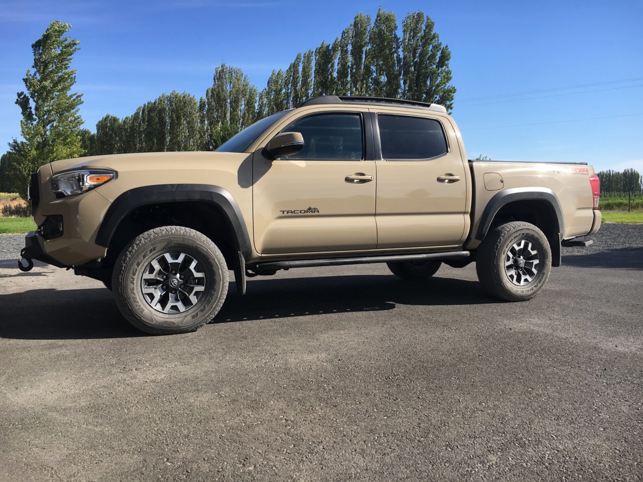

    I have the SSO slimline bumper and Smittybilt x20 winch, also have Allpro sliders. I went with 888 springs, full medium Dakars and the Nitrocharger sport shock. Front was lifted 2 1/4 rear 2. Have 1 1/2 rake. Don't mind the rake, it is a truck. Levels when loaded. The rear spring cluck when loaded heavy offload. Overall the ride is great. No settling with about 1,000 miles. IMG_0298.jpgIMG_0328.jpg

    It doesn't look like the tech even tried to adjust your caster or camber. The numbers are exactly the same. I'd take it back to them.

    Like between 2.5-3.0 on the right? I think I had heard someone said they set their to that.

    Yeah. I was able to get 2.3 out of my stock control arms with a ~1.75" Lift.
    Tell them you want 0 camber, 0 toe, and as much caster as they can get out of the control arms.

    Thanks, I'm going back Thursday :fingerscrossed:
