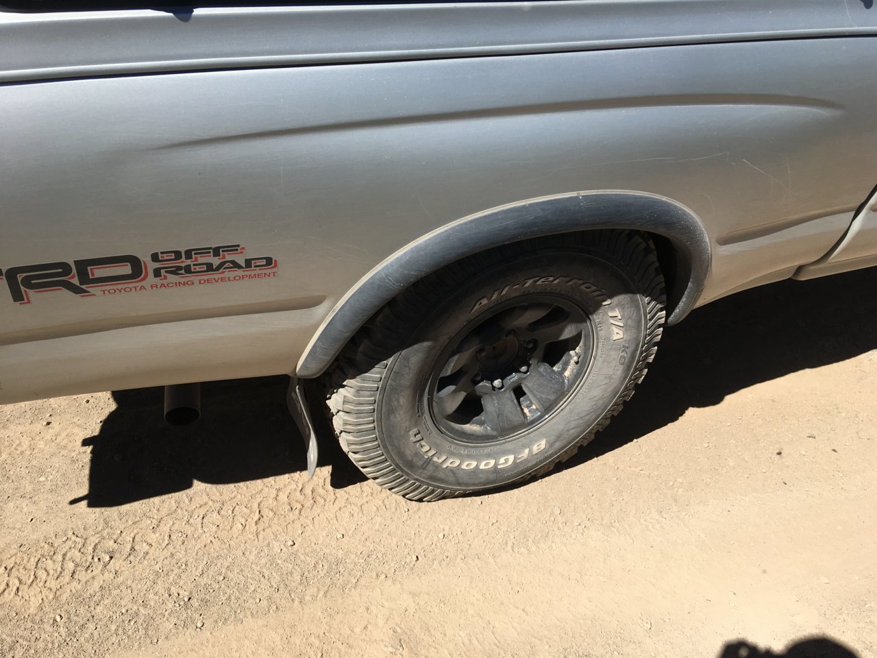

    Technically no, but it has the same effect as adding 3/4" spacers. I haven't heard of anyone having problems with them on stock rims on a 2nd Gen.
    Stock steelies with stock Dungflop 245/75R16
    1st Gen TRDs with 255/85R16 BFG KM2s
