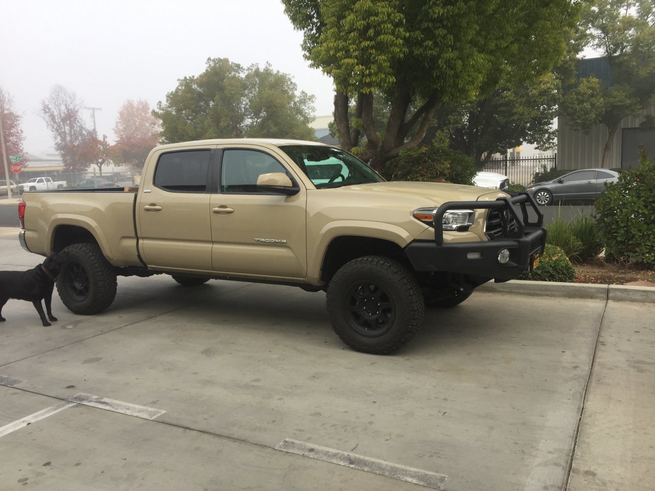

    Do the rear springs settle out? I’m not too happy with the way my truck ended up. The front doesn’t look any higher than it did with the stock springs and the rear end looks like it’s trying to pickup men of a lower caliber.
    I put heavies in the front with the trim packer on the drivers side and medium springs in the rear.

    It’s worth checking but my shop installed the spring top hat upside down when I had 885’s first installed so it literally netted me no lift...

    That’s exactly what it is. They installed the bottom of the strut in upside down. I’m going in Monday morning to get it fixed.

    Much better.

    Yup, that's about what 887's on a 3rd gen looks like. Great choice.
