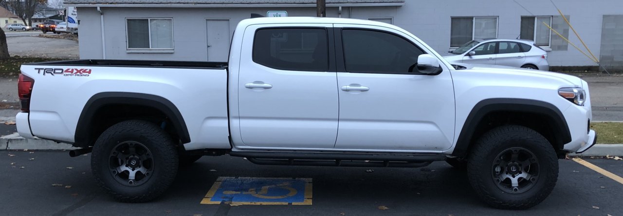

    You should measure center hub to bottom of the flair so its relevant regardless of tire size. Looks good though.

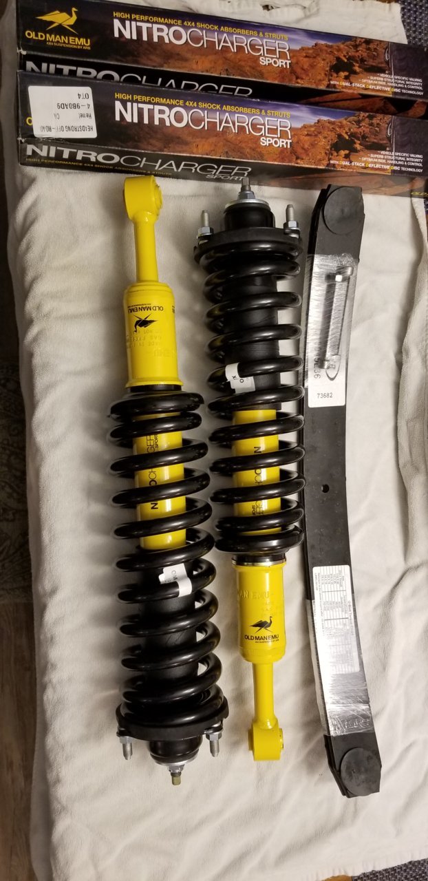

    welp. After months and months of research and saving money, i pulled the trigger on a full OME 887 set up with Dakars and LR UCA.
    MERRY CHRISTMAS to me!

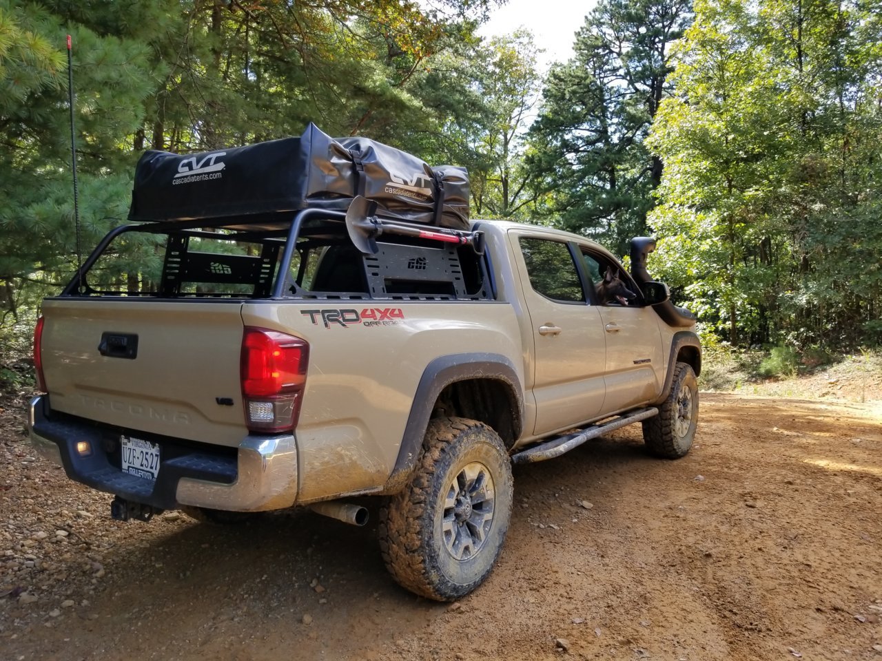

    Old Man emu 887 with Heavy dakars, 255 85 16s coopers

    Looking at the heavy Dakars as well. Did they settle to this level after a while?

    Well, in that picture I have around 20k miles on those dakars. The tent and bed rack have been up there for 15k in that picture. Once it was put on it's never been taken off. I have been offroading at least 9 times this year. With the tent probably 7.
    The will eventually sag, but they still are not level. I'm still noticeably higher in the back
