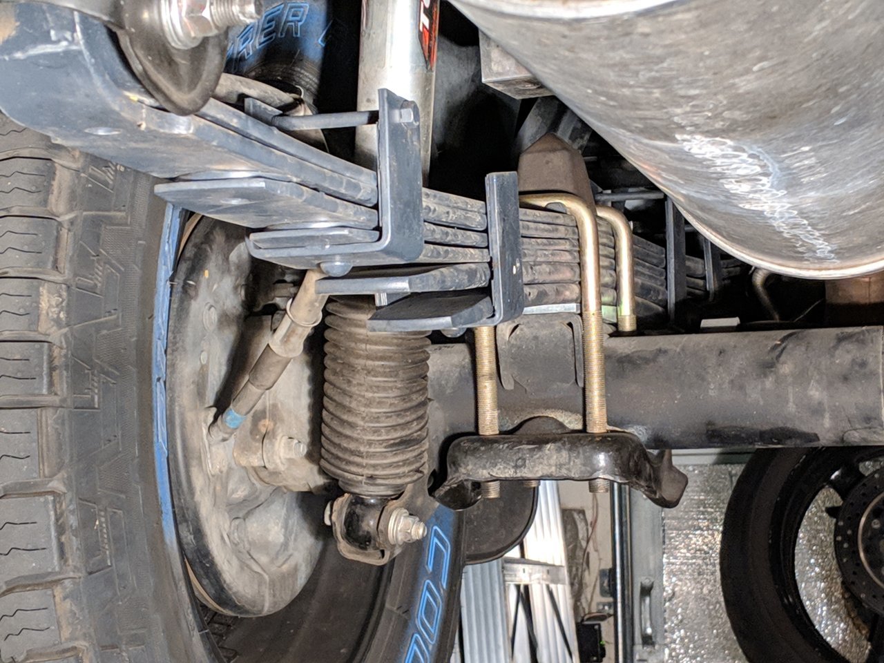

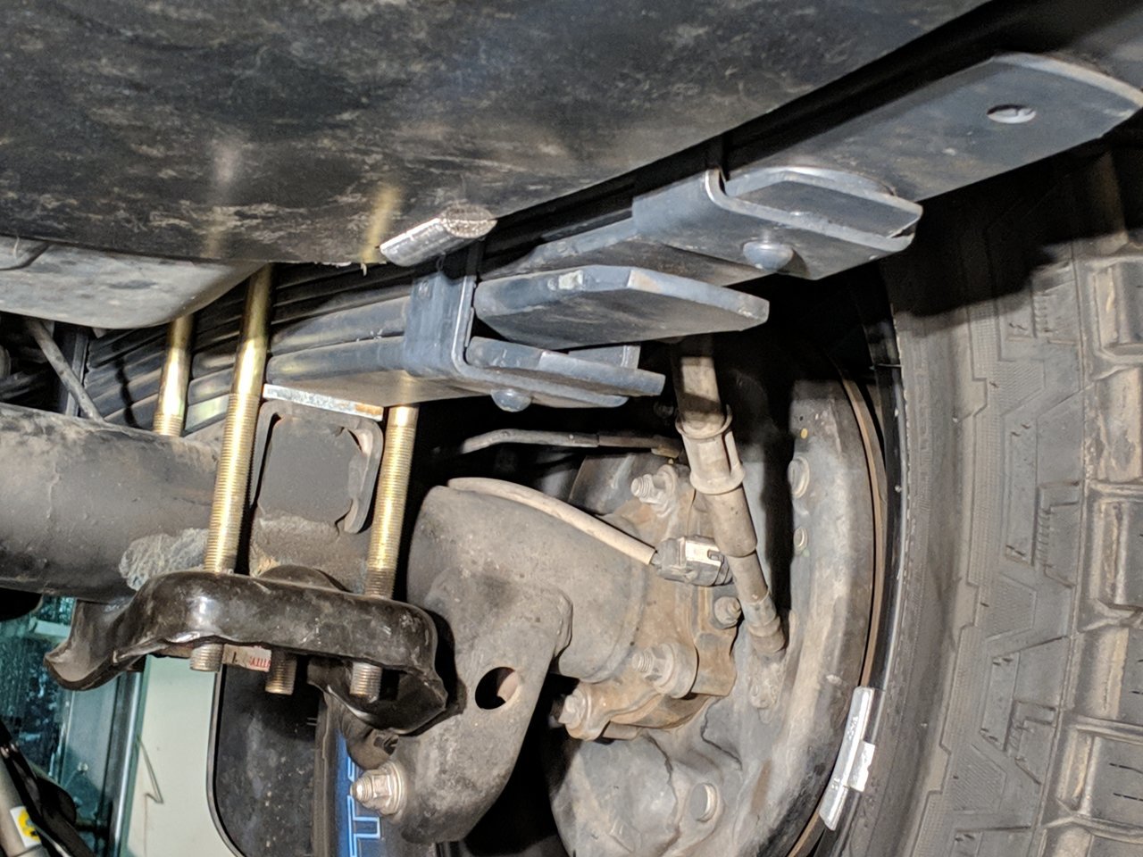

    Ok TacomaWorld OME guru's, I need your advice. I recently got a RTT setup on bed bars (so excited to camp above the ground now!) and my bed is mostly empty. About 5 months ago I got a set of ELO95s when I replaced l my shocks. I love the ride but I'm concerned about the appearance of the springs and the fact they bottom out with just the RTT. I'm afriad to load up my gear and take any trails.
    Also, how do my overload springs look? Would the OME AAL help in my case?

    My pack looks about the same and I’m planning on HD Dakars to support my RTT and the constant weight.

    I'm hoping this pack is still good and I can just add the OME leaf to make it like the 96 pack.

    I’m currently running the Headstrong Progressive AAL (3 leafs) with the TSB OEM pack, if that helps anymore.
