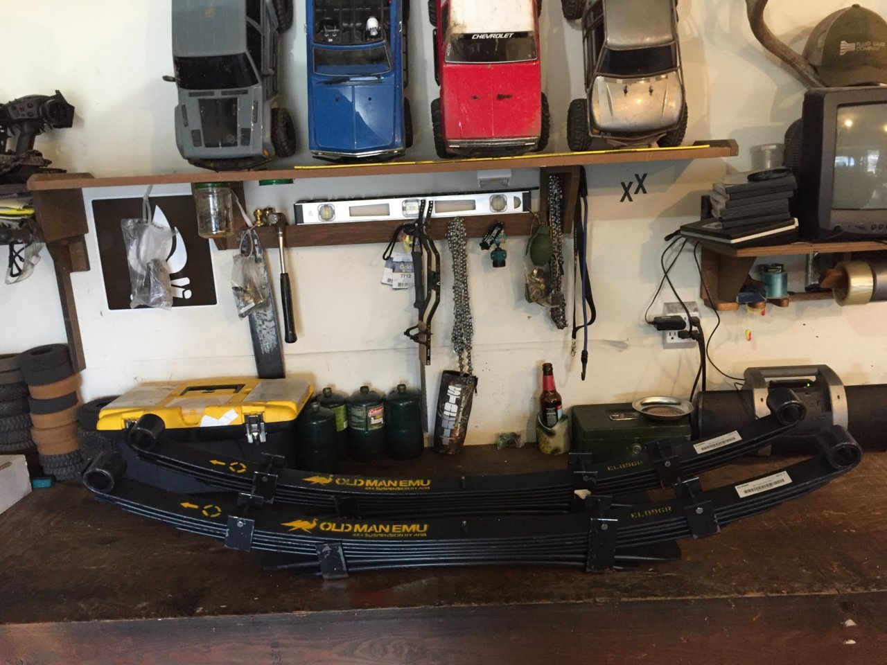

    Alight gentleman got the OME 90000/886 coilovers w/Dakar EL096R Heady D’s in the Back, first part arrived today got them leaf packs! Been reading up on info for this thread, is there any advise for install (friday!) ? Issues, parts not included, tricks? Going on 09dcsbTRDor Steel bumper/10k synth/sliders/rack/cap thanks TW

    That’s great , mine will be here tomorrow too. I can’t wait. Good luck with install, I have a guy from TW that’s going to do install for me. Are those rc10’s hanging in the wall? They look like fun

    Seems like sooner or later most people end up doing 3 degree shims. I suggest doing it during install which also may require center pin extensions. I have the same leaf packs and have a little vibration. heading toward shims myself after I rule out any tire issues.
    Good luck! its gonna be great!

    Ya got a couple scx10s one is a vatarra all super fun

    Don't do this vvv
    The best thing you can do is measure your driveline angles prior to lifting it so you have a reference point, post install, if you have vibes. So many people want to throw shims or CB drops into the mix when they dont even know what they're solving for. If you take the correct approach and do math camp, solving for vibes is relatively straightforward.

    I had good luck with the 3 degree shims and no CB drop on my access cab.
    Be careful of the brake lines when removing and installing the packs. Take your time and lube everything up well.

    Will new break lines be needed or are the stock lines still long enough

    They're long enough but a lot of people upgrade them to SS and few inches longer for piece of mind, myself included.

    I did also get a relentless Ubolt flip kit and new wheelers super bumps for front and the back along with new top hat bushings and rubbers but didn’t think about the break lines. I suppose ordering up some 3dgree shims would be good to have on hand for if needed
