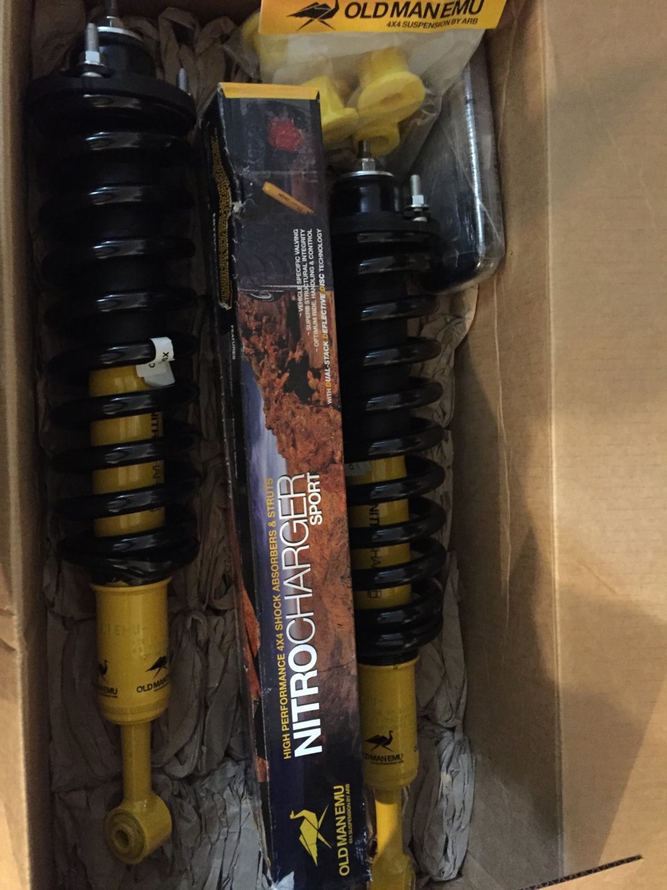

    They have arrived! Question how is one to tell which is drivers side ( trim packer) can’t seem to figure which is which only looked for a min or two but I can’t see a difference-
    saundern likes this.
  8. Jan 8, 2019 at 7:17 PM
    Yota Bucket
    Yota Bucket Well-Known Member
    Jan 16, 2017
    #207769
    359
    Mt. Shasta CA xX
    2009 TRD TACO
    Figured it out found the spacer at the bottom of one side of the 886 coils it was painted black so I didn’t notice it right away

    there should be a little "gold" spacer ring at the bottom of one of those springs.
    I had the same thought initially, cause i was expecting a bigger spacer (more noticeable). But alas. It's worked fine on mine
    Yota Bucket[QUOTED] likes this.

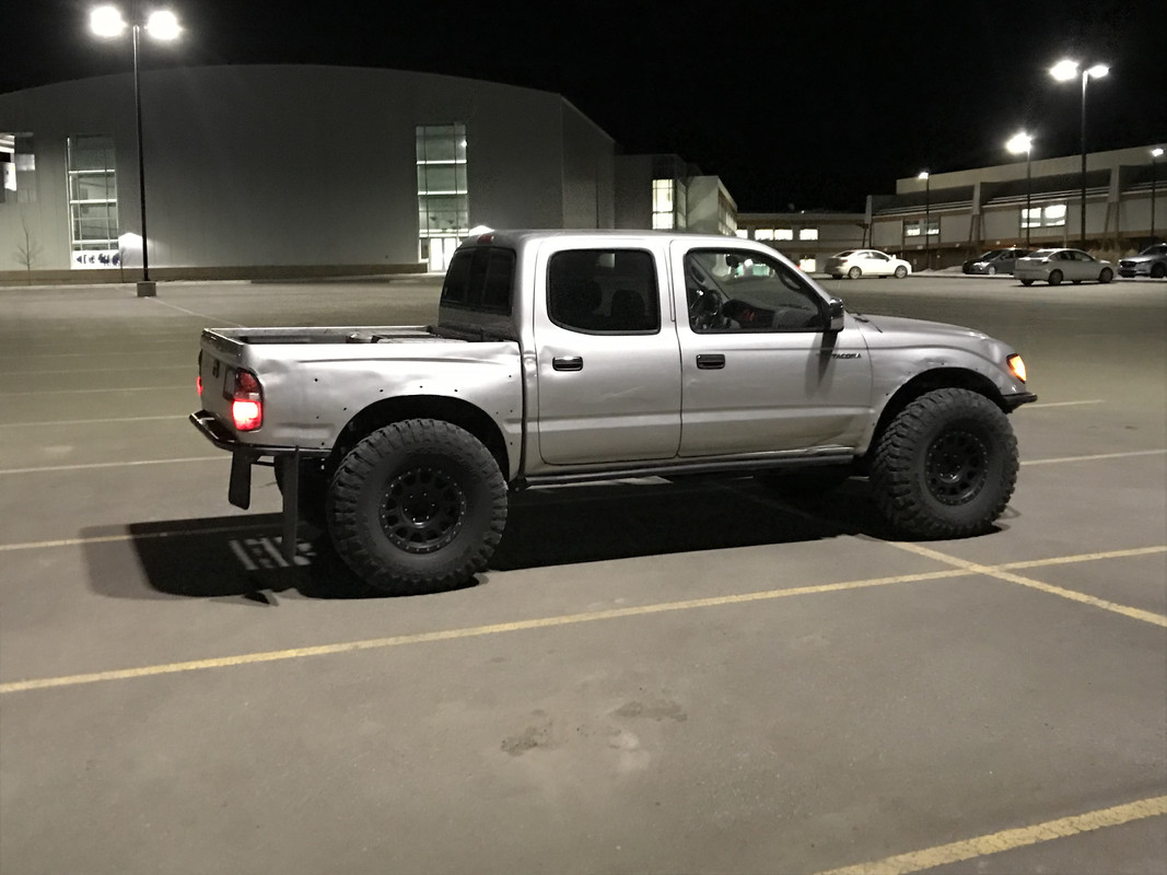

  19. Jan 18, 2019 at 8:27 AM
    HeadStrong Off-Road
    HeadStrong Off-Road Well-Known Member Vendor
    May 28, 2015
    #156242
    4,034
    2011 Toyota Tacoma and 2019 4Runner
    Very nice looking @longspear !!! Sorry it took me awhile to comment. I haven't been able to get to my Alerts since Xmas (too busy with PM's :) ) Thank you again for your business we truly appreciate it!! :cheers:
