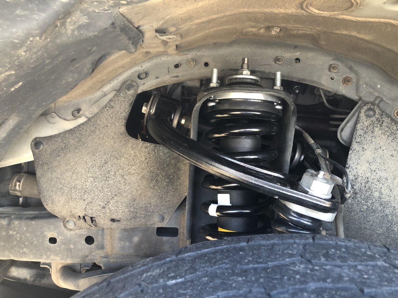

    Thanks, I'll check the angles before installing them and return if unnecessary. I tore into the front suspension tonight...06, everything is rusty and tight. I ran into one big problem: The shock nuts on the old shocks were really tight. I had to use a hammer and box end wrench the whole time, then I rounded off the inboard shock nut on both sides pretty badly...any suggestions? I can't get in there with the sawzall on its side. I loaded them up with PB Blaster for the night and will try vice grips in the morning. Anyone else run into this?

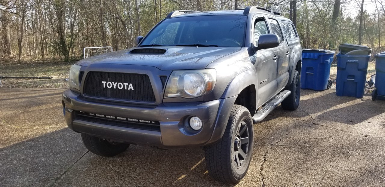

    I'll be honest, I did not take down measurements before I installed everything so I don't know exactly lol. I'm pretty confident I got the amounts claimed on the website; 2.5" front and 2" rear. I know for sure that now I only have about .5" of rake which looks great in my opinion. I did leave the overload leaf in.
    Here's a pic after the lift, I'm on 265/75/r16s.

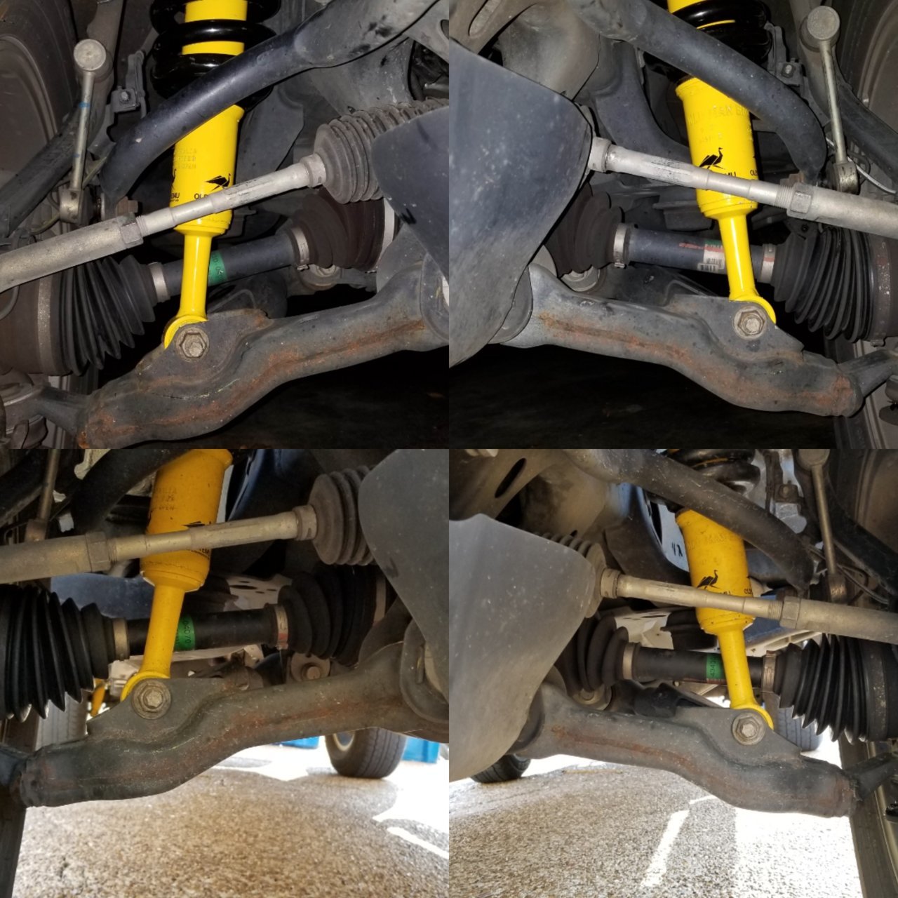

    CV angles are from install day (top) to current (bottom). No diff drop. Full medium Dakar pack. 3° shims. Cb drop. Full OME 887/sport coils

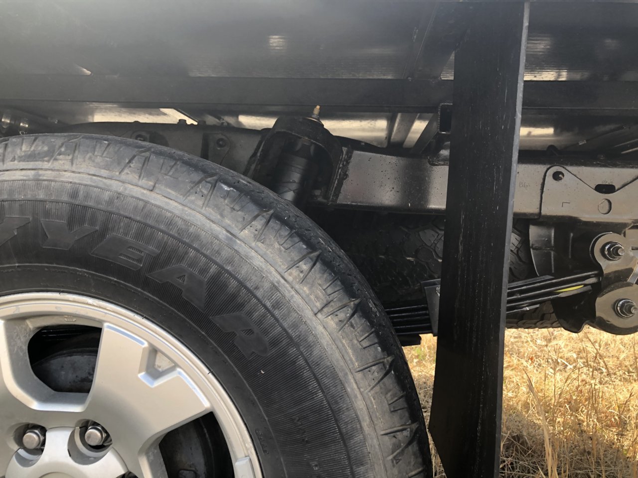

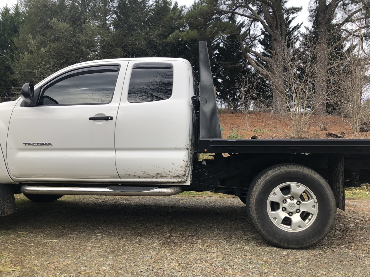

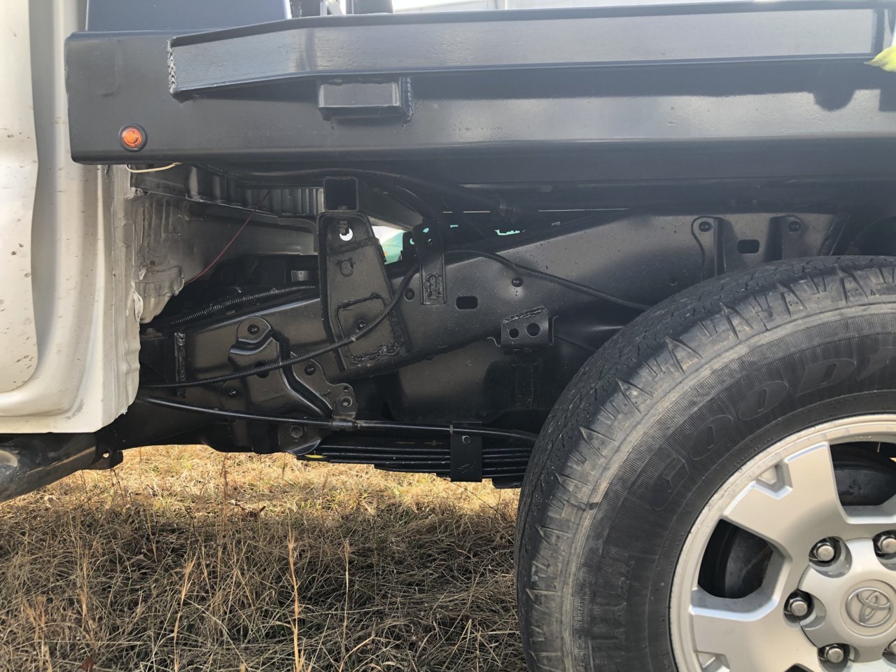

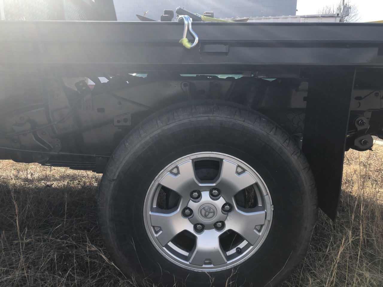

    I just had a full OME loft installed on my 2008 V6 4X4 access cab. The truck has a flatbed on it that I do not know the weight of. I went with 884 coils and 90021 shocks and went with the EL096R heavy Dakar leaf pack. It looks to me like I still have to much weight on the rear. I have 285 tires I need to fit under it still what do you guys think. What would your next step be if it was your truck. I just noticed I only got close up pics of the leaf pack. I will get a shot with the whole truck after alignment tomorrow. Thanks

    AAL

    what AAL would you use with the Dakar HD leaf pack?? Any idea to tell how much more I need in the back with out guessing?? or taking the bed off and weighing it?

    Wheelers has OME AAL. Get one of those.
    Go to a truck scale and weigh your truck, then you should be able to determine a ballpark of how much your bed weighs.

    Def get the heavy OME add a leafs. Looks like you need it. Damn that under carriage looks clean! Show a pic of your truck!

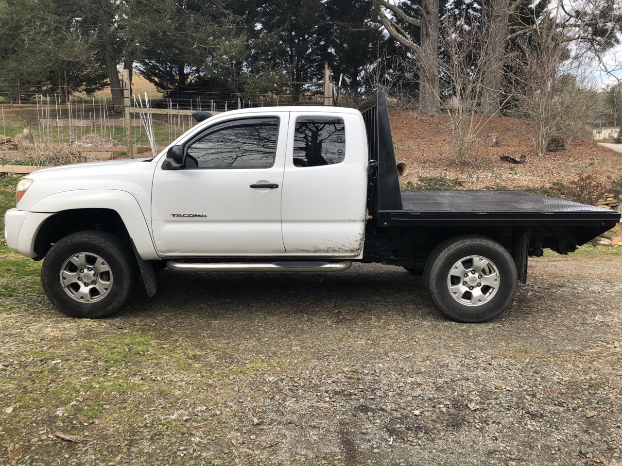

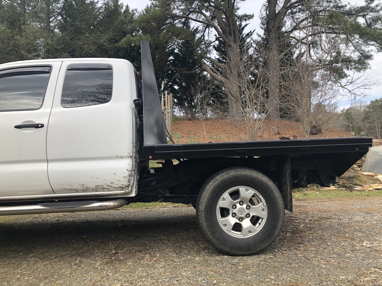

    Here are some more pics. I went with the EL096R-P instead of the EL095R-P. I think that has the extra leaf in it already. Can I just keep adding more of the EL46XL-P extra leafs. I think that extra leaf is the only difference between the two leaf packs OME offered with lift. We all agree though that if I am going to adding a couple hundred more pounds to the bed(RTT and gear) that I will need to do something more in the back. I have 285-70 tires to put on it still. Maybe tomorrow I’ll see how they fit. I think I am going to have an issue with clearing the bed.

    would anyone with the HD Dakar's be willing to snap a pic so I can see how I am sitting compared to someone else. Thanks
