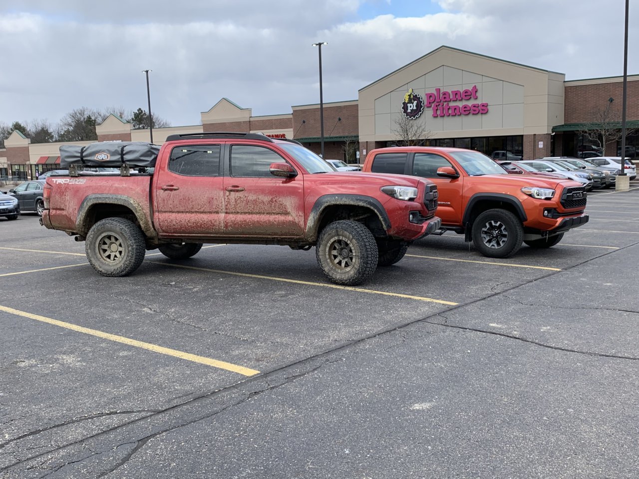

    Picture with the RTT on for the season now.

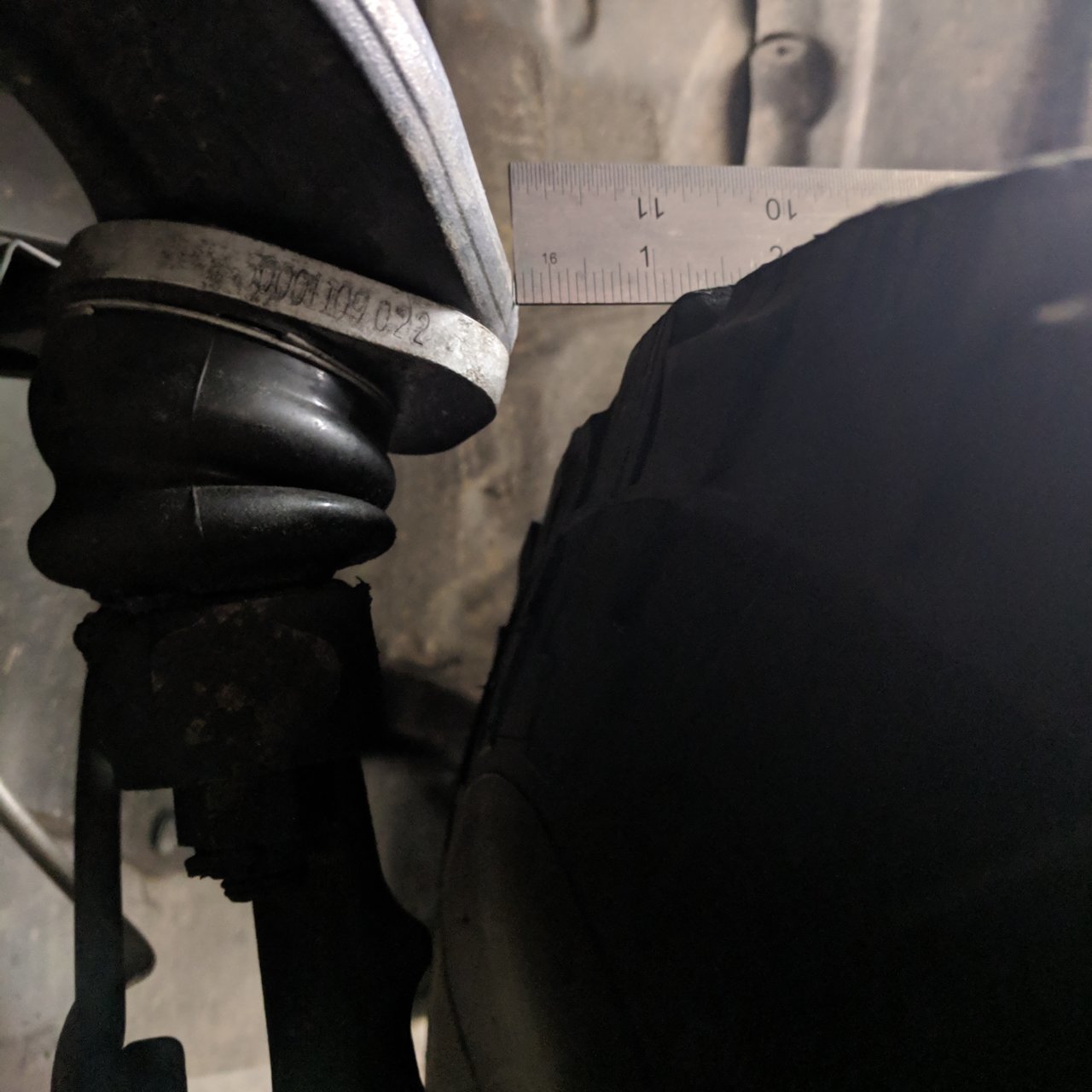

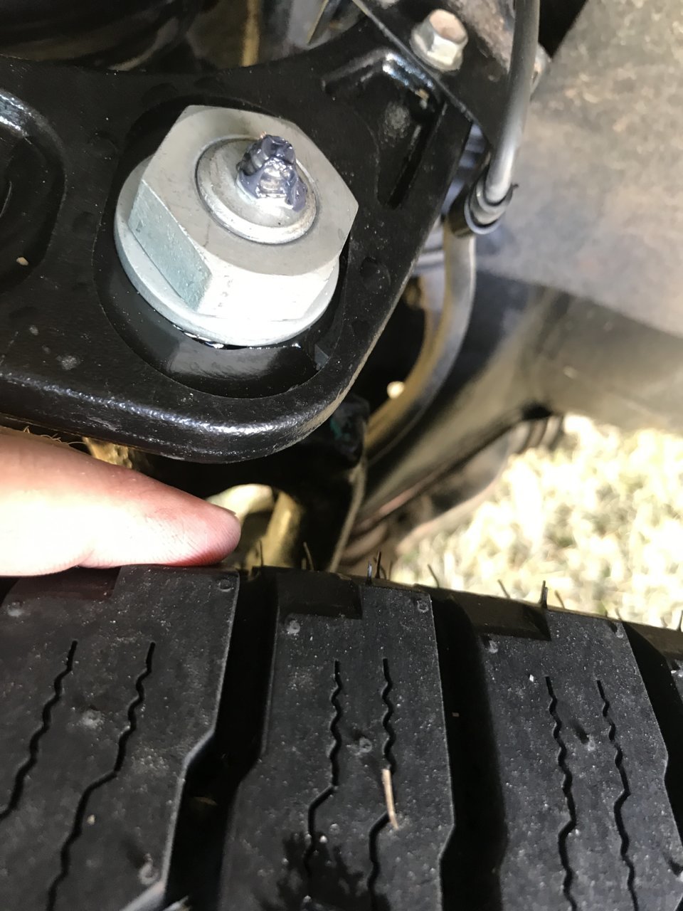

    7ED44055-6D8D-4AB7-A141-041BBC9A61BC.jpg 5AF1931C-C689-4C5E-BFC1-9B62F4064DB8.jpg After sitting in the garage for three weeks, I finally got a chance to install my lift. OME 886 w/ Dakars 95R. I was worried about it being too stiff but rides great. Or at least better than before. No more bottoming out over dips in the road. However, what are the thoughts on the clearance here between the tires and UCA’s?
  18. Apr 8, 2019 at 8:24 AM
    la0d0g
    Jan 25, 2011
    #49903
    19,907
    running for the hills
    For crawling not hauling
    If your finger fits you're fine.
    Guardian[QUOTED] likes this.

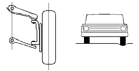

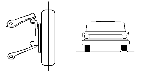

    its close on mine too, stock OR TRD 16" wheels, 265/75/16 with an OME BP-51 suspension and the SPC UCAs.

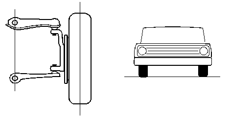

    as long as it's not constantly rubbing, remember the tire wall does not move inward on compression with IFS and the uca moves with it.
    found some diagrams:
    http://www.joesfalcon.com/page12.html
    /edited for diagrams, wording
