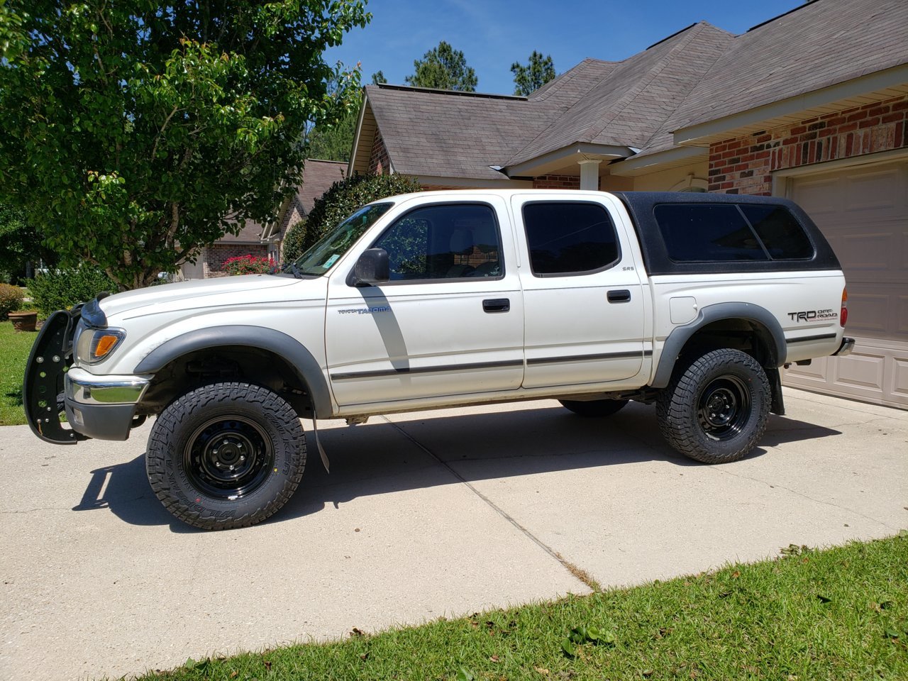

    Most recent update to the rig.
    OME setup rolling strong for almost a year now. Dakar packs have become a little less noisy, and everything has settled nice and level, front to back.
    A recap for the curious:
    2003 PreRunner DC
    881 coil and Dakar leaf springs
    Nitrochargers at all corners
    SPC UCAs still at factory settings.
    Just completed my LCA bushings using Whiteline polys and replaced all of my steering linkage, prior to new shoes. So happy with the results.

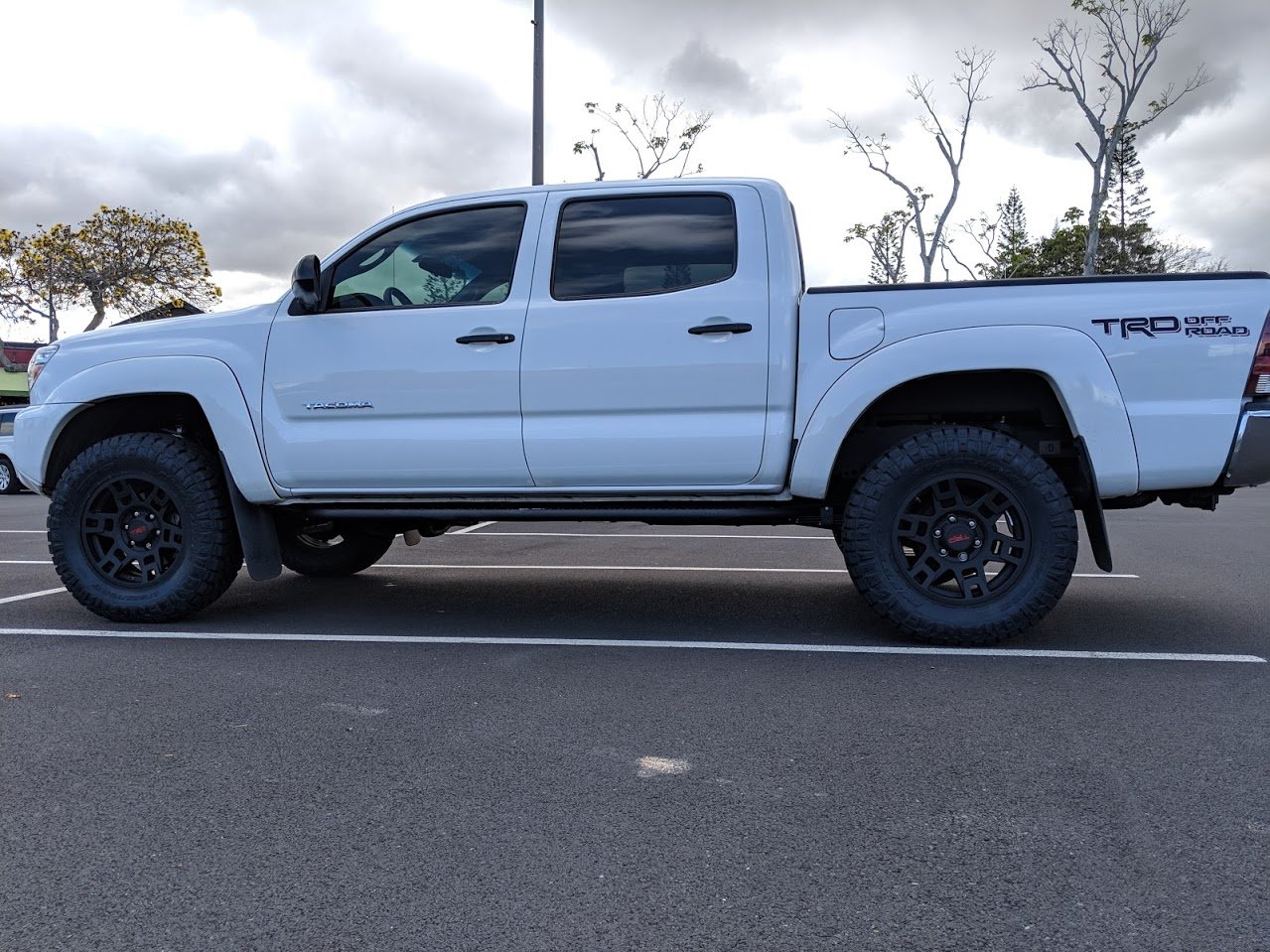

    OME Lift Kit: Front 90021 shocks with 885 coils. Nitrochargers 60091 shocks in the rear. Medium Duty Dakar leaf pack. 17 in TRD rims wrapped with Nitto Ridge Grapplers in 265/70/17
    I just got my OME set installed.
    U__CLjQG_0Y2QUu7zq2Qa5QU6WxofYWZGRkgb-W8_d365895a80a8db991c5b2b7db3be094dc85377e9.jpg
    Front: OME 90021 sport shocks with 885 coils
    Rear: Rear OME Nitrocharger Sport 60091 shock.
    EL095R - Standard Dakar Leaf Pack

    How’d the alignment do? I’m looking at that same set up.
  18. Apr 20, 2019 at 1:14 PM
    zert808
    zert808 Well-Known Member
    Jun 2, 2015
    #156560
    109
    D
    Mililani, HI
    2015 White Tacoma OR DCSB 4x4
    I still have to take it for an official alignment.
    But it shouldn't be too hard, since the lift is just under 3 inches. You can get away with stock UCAs. I got LR UCAs to make it easier
