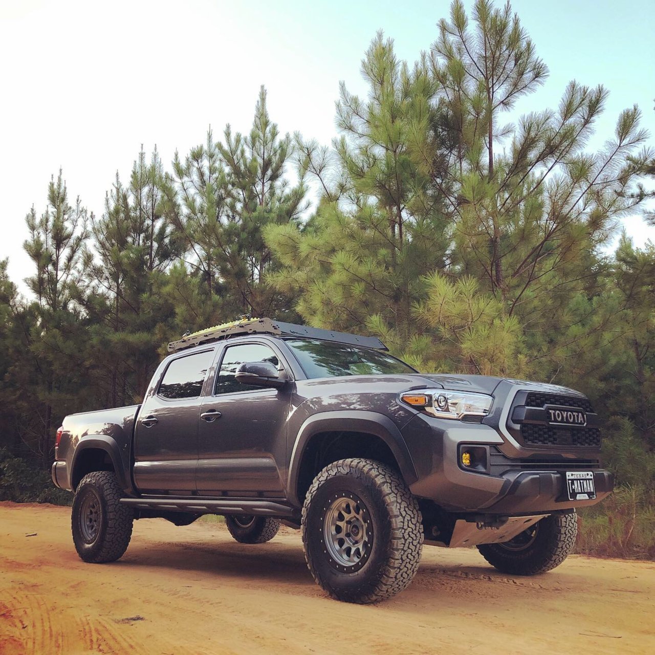

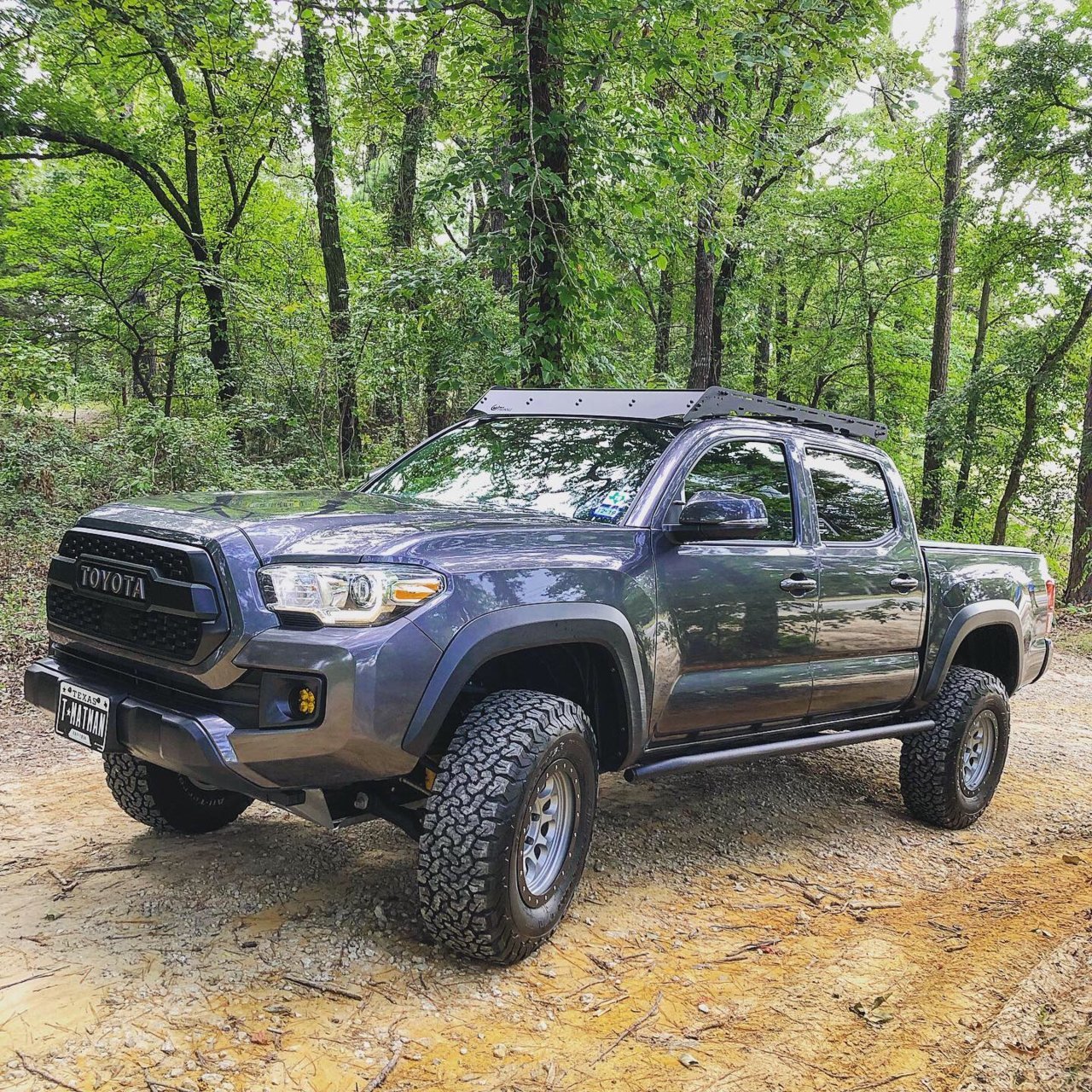

  10. Aug 17, 2019 at 1:21 PM
    TXTRDOR
    TXTRDOR IG @txtrdor
    Aug 29, 2018
    #264484
    187
    18 DCSB TRD OR 4X4
    887s and medium Dakars. Get the soft-ride shocks up front. I had a similar OME setup on my ‘16 4Runner Trail as well. Great products.

  11. Sep 11, 2019 at 12:47 PM
    ninernation
    ninernation Well-Known Member
    Dec 6, 2012
    #92560
    1,060
    WA
    TRDOR
    OME, ALUCAB, RCI
    How long have you been running this setup? May I ask your hub to fender measurement up front?
    I'm only getting 22" up front hub to fender with the 887's. I have an aluminum skid and sliders but I see you have these too. Kind of funny since they rode really high when brand new.
    I'm wondering if I have bad 887s (my medium Dakar are being warrantied) or if the skid and sliders are too much. The suspension was installed last November. I'm not sure if I swap to 888s, top plate spacers or try a new coilovers to get back up to 23.5"-ish
