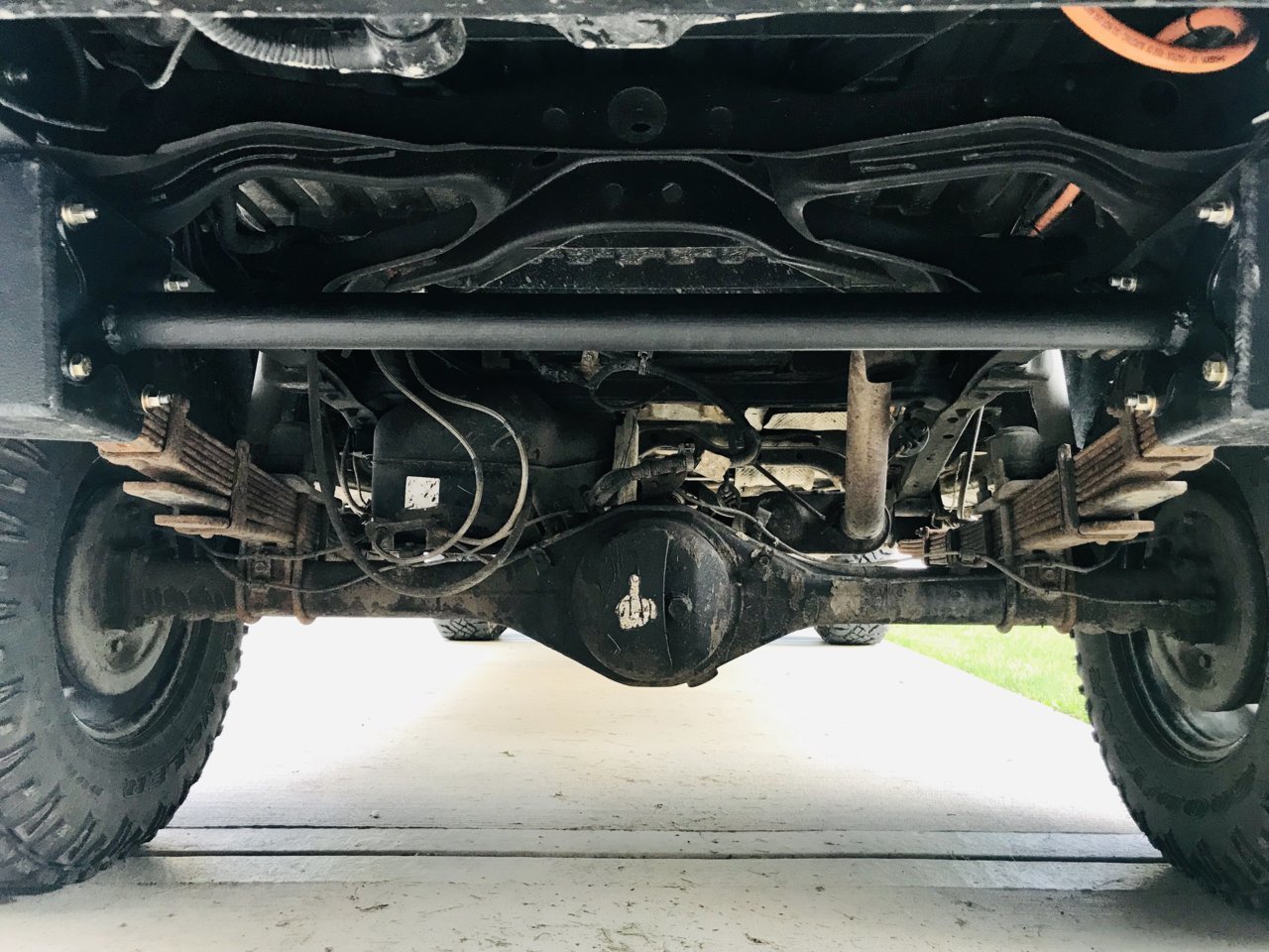

    For you guys running the OME (ARB) HD leaf packs can you post pictures of your leafs. Please include your mileage. I've included pictures of my leaf pack to provide an example.
    Hers a bit of back story to explain better.
    "On 11/25/2018 I ordered a set of OME Heavyload EL096R leafsprings from Low Range offroad and installed on December 10, 2018. Shortly after I noticed after I noticed that the springs appeared to be settling much lower than anticipated. I contacted Low Range and was informed that I would have to take it up with arb. Upon contacting arb I was informed that "it was normal settling". Fast forward to now and my leafspring appear to be developing a reversed arc. My truck is my daily I do not tow and besides my Allpro bumper and spare tire I rarely carry any additional weight."

    This was about 25k on them...hard angle but if you zoom in you can see they were flat or slightly recurved:
    DCSB, Leer 100R with pelfreybilt high clearance bumper with swing out
    Ironcross6921 likes this.

    They look flat lol but hard to tell from the angle if they've started to negatively arch right above the axle.
    Looking at your diff I think I may have a sticker made
    :brianr: ARB/OME
