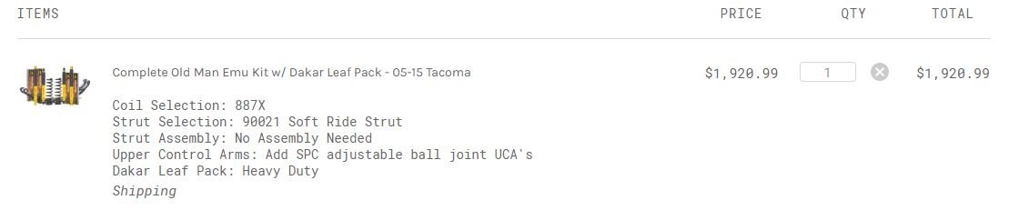

    I'm looking to do a suspension refresh at 130K after getting my original OME setup on at 40. Where is the best place to get a good deal?
    In addition to leaf springs, rear shocks, front coilovers... what else should I consider changing in the process? 2 new CV axles and new lower control arms?
  20. Mar 3, 2020 at 7:26 AM
    BraskaTaco
    BraskaTaco Well-Known Member
    Jan 11, 2016
    #174711
    2,144
    Midwest
    2013 Tacoma TRD OR
    In my cart at Headstrong:
    Planning to run 1/2" and 1/4" strut top spacers instead of the 886's (aluminum bumper with winch). Also switching from Total Chaos to SPC because of the noise.
    Edit: Should I also get extended brake lines? I don't have them currently..
