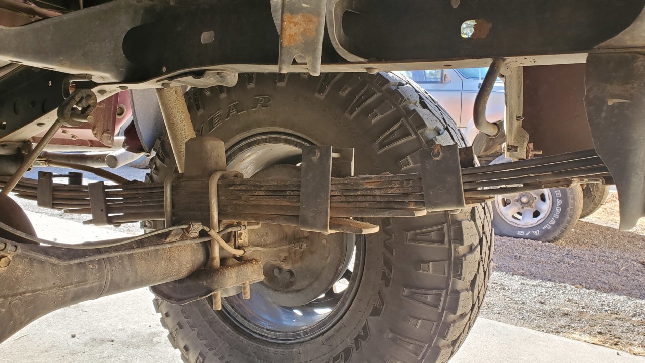

    Had my Dakar EL096R leafs on for a while now. Planned to have a toolbox full of tools n gear in there by now, but it hasn't happened yet, will soon though.
    Problem is, I'm getting every bit of near 3" in the rear and it's pretty stiff. I'd like to chill the leafs so they aren't so harsh without weight and get my flex back. Which leaf is recommended to remove to help this?
    Aaronparker001 likes this.
  16. Apr 17, 2020 at 12:45 PM
    la0d0g
    Jan 25, 2011
    #49903
    19,908
    running for the hills
    For crawling not hauling
    I'm pretty sure its 2nd from the overload.

    2nd leaf from the bottom up toward the bed? Thought I also read here that removing one of the 2 overloads will also get more flex, and less capacity, though.

    I believe both are true.
