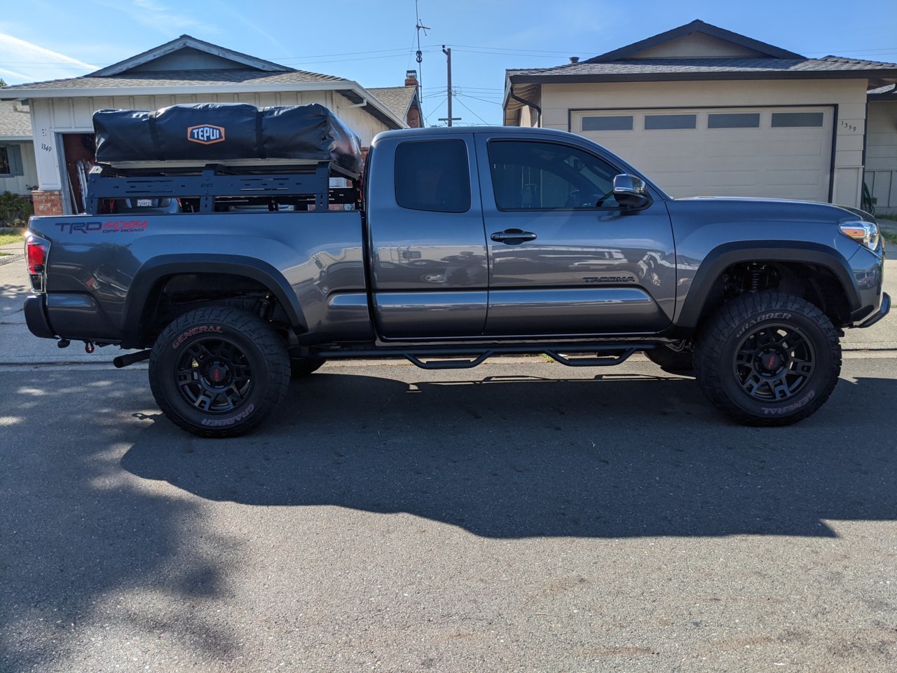

    Today was the day. After a new setup, RTT plus motorcycle on the tow hitch, the truck was sagging and hitting the bump stop with weight. after talking with a fellow TW member, we came to the conclusion that the OME complete suspension setup was the way to go. The install was time consuming but fairly simple. Also installed leaf spring liners. Just above 21/2 in the front and just under 3 in the rear. Very happy with the outcome and the ride!!!

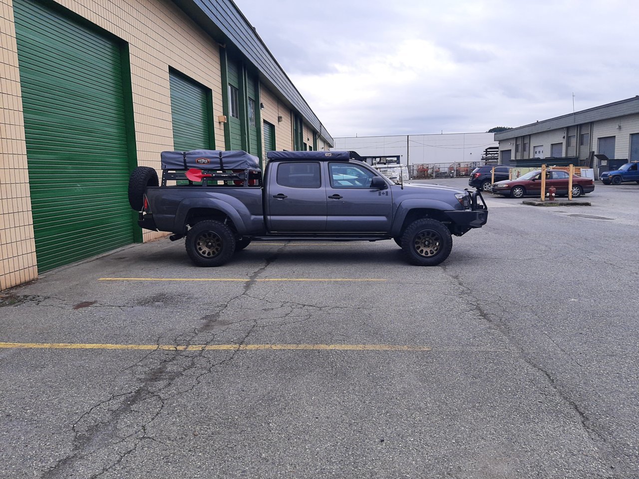

    Here's my truck with bp 51s in the front and medium's in the back with the ome aal.i have 265 70 17 atm but going to 285 70s pretty quick here.

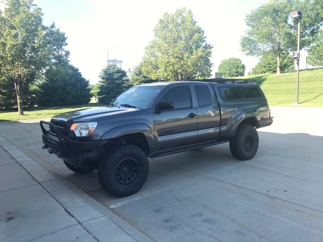

    Not the greatest pic, but I'm really happy with how the 887's + 1/4" spacer turned out in the front. Aluminum bumper + winch.
