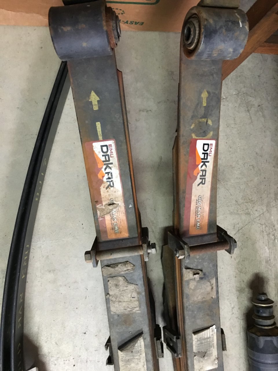

    Which one of these Dakars goes on the drivers side?

    I would put the one on the right on driver, put the minus on Passenger
    edit: why? Gas tank and battery are on driver.

    Thank you for your reply. Can anyone confirm this? I’m only wanting to put them on once :D

    You'll get the same answer, but I would be more concerned about the amount of lift you will get. Will you carrying weight in your bed full time?

    For crawling not hauling
    That's the right answer.

    I already have Dakars in the rear. Just both have a + and the passenger side sits a touch higher than the drivers side. I’m kinda OCD about this kind of stuff so, when my buddy replaced his leafs, he sold me his. And no, I don’t usually cary a lot of weight in the bed. Eventually I’d like to get a steel high clearance bumper though.

    I concur !!!
    A (+) marking means the spring rate is slightly above manufacturer's standard (In this case, Old Man Emu (ARB));
    A (O) marking means the spring rate is within manufacturer's standard; and
    A (-) marking means the spring rate is slightly bellow manufacturer's standard.
    It is common to find mixed kits, i.e. one spring being (+) and the other being (-). The (-) always goes to the passenger side to alleviate the infamous taco lean issue. There is more weight on the driver side due to the fuel tank and the battery.
    This is information I researched for way back in 2013 and is still true.
